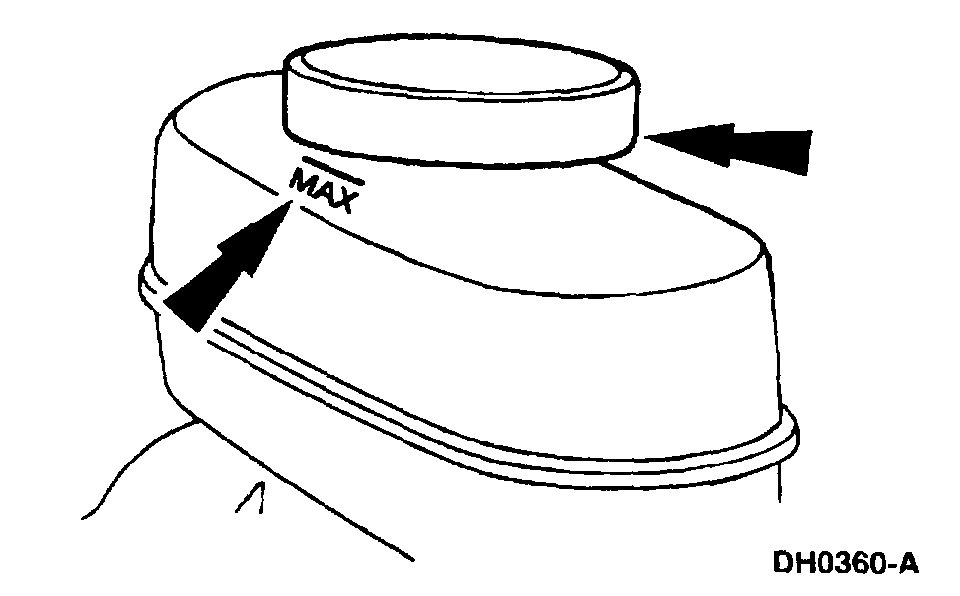

1. Clean all dirt from and remove the brake master cylinder filler cap and fill the brake master cylinder reservoir with the specified brake fluid

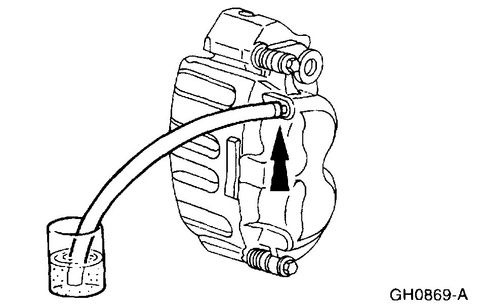

2. Place a box end wrench on the RH rear bleeder screw. Attach a rubber drain tube to the RH rear bleeder screw and submerge the free end of the tube in a container partially filled with clean brake fluid.
3. Have an assistant pump the brake pedal and then hold firm pressure on the brake pedal.
4. Loosen the RH rear bleeder screw until a stream of brake fluid comes out. While the assistant maintains pressure on the brake pedal, tighten the RH rear bleeder screw.
- Repeat until clear, bubble-free fluid comes out.
- Refill the brake master cylinder reservoir as necessary.
pic 3
5. Tighten the RH rear bleeder screw.
6. Repeat Steps 2, 3, 4, and 5 for the LH rear bleeder screw.

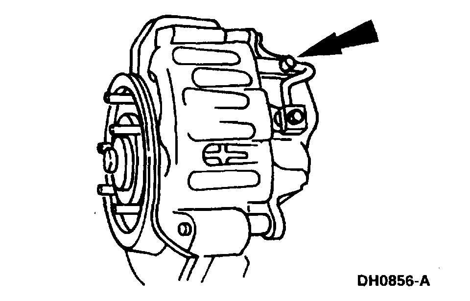

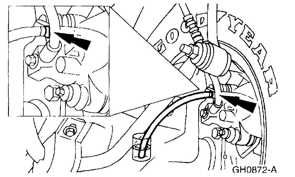

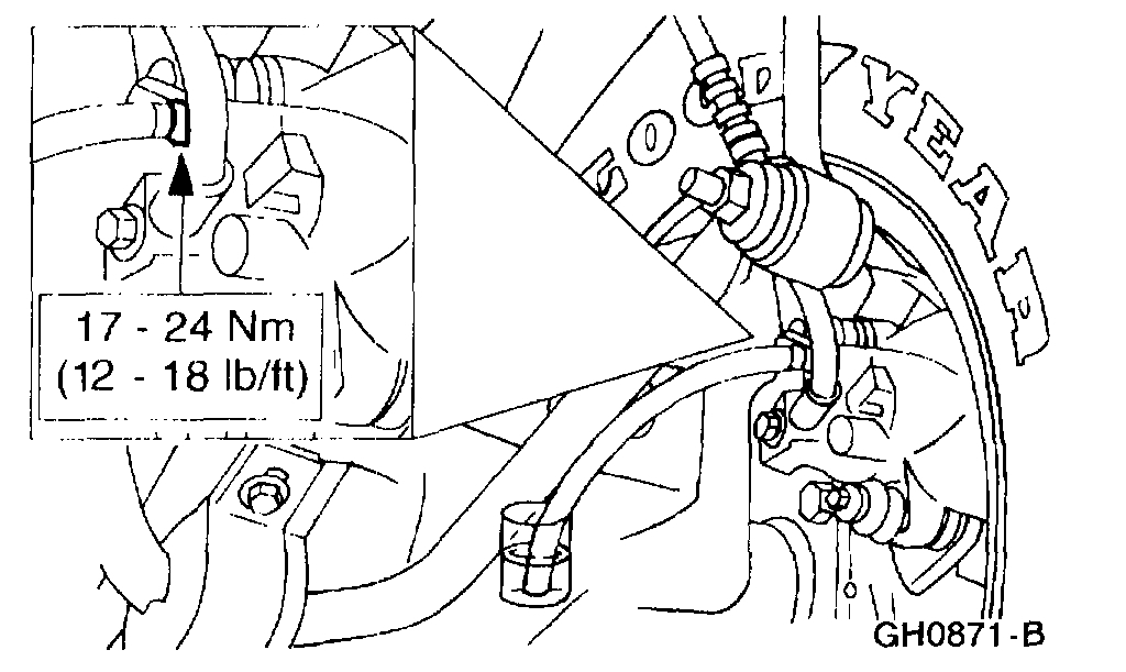

7. Place a box end wrench on the RH front disc brake caliper bleeder screw. Attach a rubber drain tube to the RH front disc brake caliper bleeder screw, and submerge the free end of the tube in a container partially filled with clean brake fluid.
8. Have an assistant pump the brake pedal and then hold firm pressure on the brake pedal.
9. Loosen the RH front disc brake caliper bleeder screw until a stream of brake fluid comes out. While the assistant maintains pressure on the brake pedal, tighten the RH front disc brake caliper bleeder screw.
pic 5
10. Tighten the RH front disc brake caliper bleeder screw.
11. Repeat Steps 7, 8, 9, and 10 for the LH front disc brake caliper bleeder screw.

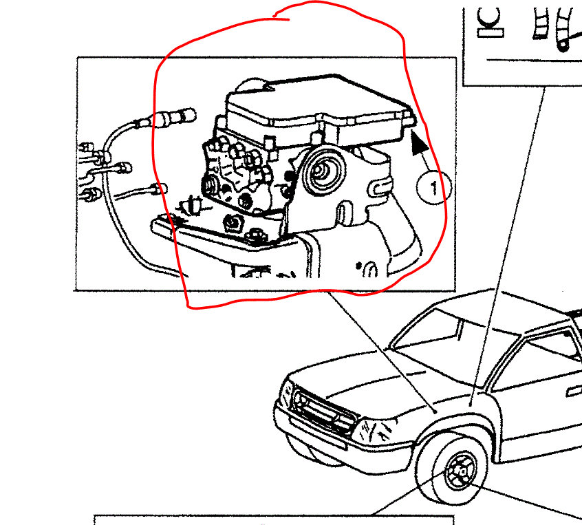

Okay. I cannot get fluid to the caliper to be able to use the bleeder. The 2 lines coming off the master cylinder go to a thing that has 3 more brake lines coming out of it. It is some kind of pump. I can get fluid from the master cylinder lines down to where they connect to it but that's all. I assume the other brake lines connected to it go to the 2 front and one for the back. When I pump the brakes up I can c air getting in to the reserve. I put a new booster on it. is there some kind of adjustment you have to do to the booster?
Mar 10, 2021 at 12:52 PM
  • 110,193 POSTS
I attached a picture. Is that the part you are referring to? If you remove one line at a time from the wheel side, will it bleed?

1. Clean all dirt from and remove the brake master cylinder filler cap and fill the brake master cylinder reservoir with the specified brake fluid.
2. Install the bleeder adapter to the brake master cylinder reservoir, and attach the bleeder tank hose to the fitting on the adapter.

3. Place a box end wrench on the RH rear bleeder screw. Attach a rubber drain tube to the RH rear bleeder screw, and submerge the free end of the tube in a container partially filled with clean brake fluid.
NOTE: Bleed the longest line first. Make sure the bleeder tank contains enough specified brake fluid to complete the bleeding operation.
4. Open the valve on the bleeder tank.
pic 4
5. Loosen the RH rear bleeder screw. Leave open until clear, bubble-free brake fluid flows, then tighten the RH rear bleeder screw and remove the rubber hose.
6. Continue bleeding the rear of the system, going in order from the LH rear bleeder screw to the RH front disc brake caliper bleeder screw ending with the LH front disc brake caliper bleeder screw.

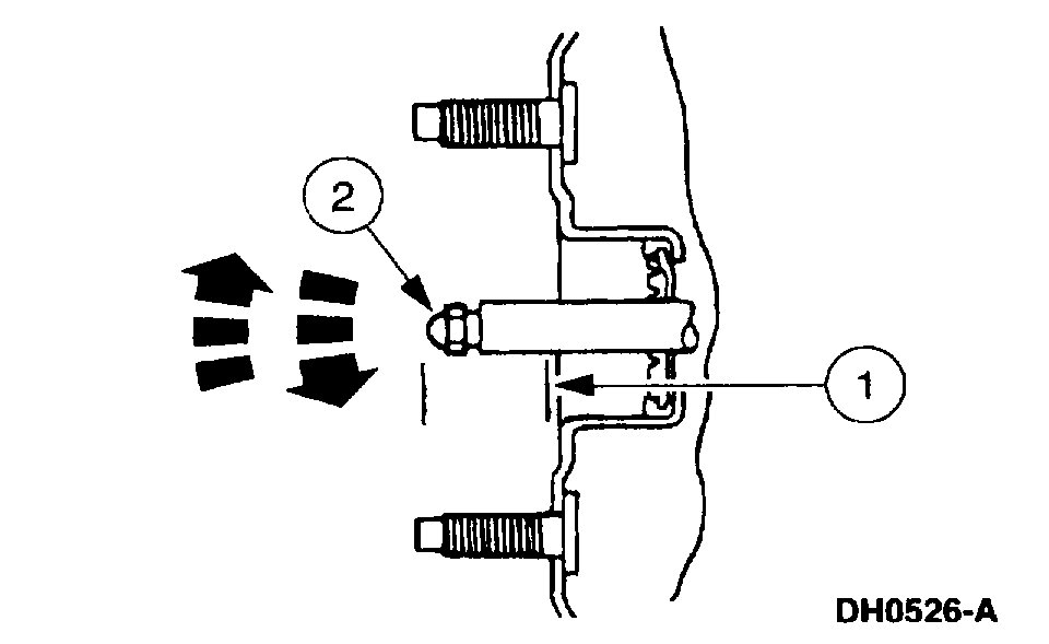

Next is adjustment. If the push rod isn't actuating the new master cylinder properly, it may not build enough pressure to work. Here are the directions for adjustment. The last pic correlates with this.
________________
1998 Ford Truck F 150 2WD Pickup V8-4.6L SOHC VIN W
Master Cylinder Push Rod
Vehicle Brakes and Traction Control Hydraulic System Brake Master Cylinder Adjustments Master Cylinder Push Rod
MASTER CYLINDER PUSH ROD
1. Remove the brake master cylinder.
pic 5
2. Adjust the power brake booster to brake master cylinder push rod, vacuum applied.
1 Measure the power brake booster to brake master cylinder push rod.
2 If necessary, adjust the screw to the proper length.
CAUTION: Do not apply the brake pedal with the master cylinder removed from the booster.
3. Install the brake master cylinder.

Yes, the picture you sent is what I was talking about.
  • 110,193 POSTS
Okay, then I suggest first confirming that the push rod is adjusted properly. If it is, try pressure bleeding the unit or bleed it manually at the abs module (opposite side of the master cylinder). If that doesn't work, you may have gotten another bad master cylinder.
