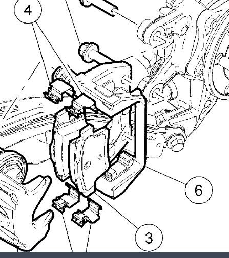

I am installing brake pads on the rear. I have no problem getting the outside brake pad to fit into the clips. But cannot get the rear pad on for nothing. Is there some trick or something I do not know about?

There really is not a trick. It should fit into the mount. Make sure to remove any rust or dirt that has developed over time. Most times, brake pads will get stuck when rust expands where the pad or spring clip hardware mounts. (See picture 1 component 4) I always remove the spring clips, take a small file, and take it back to clean metal then a touch of brake grease. If there is excessive rust under hardware, it presses in on the hardware and freezes the pads. And, it can cause it to be nearly impossible to install the new pad. Many times, I have had to hammer out old pads because they are so tight.

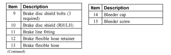

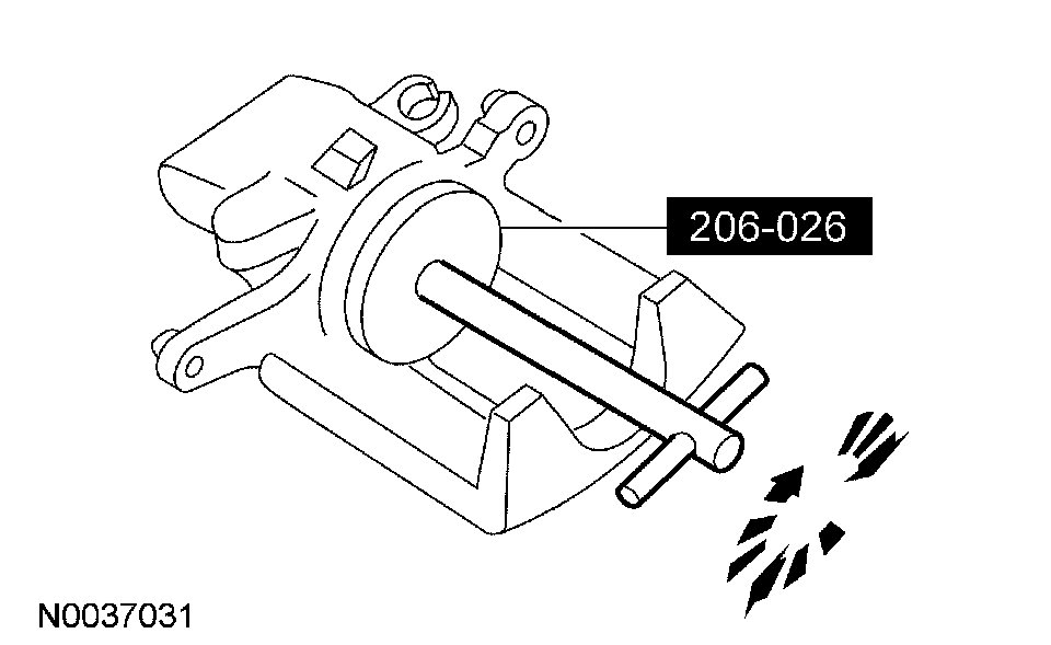

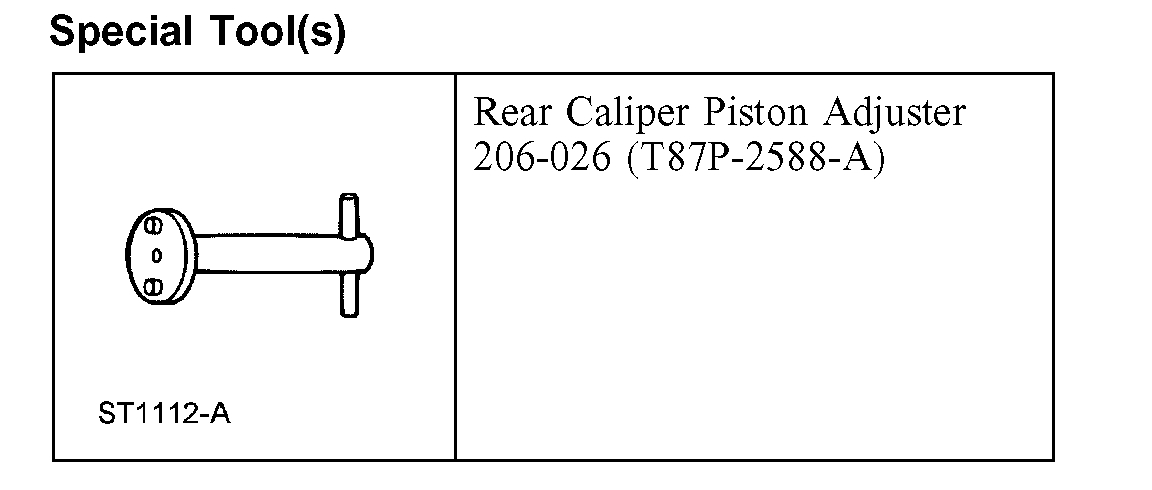

Special Tool(s) See picture 2

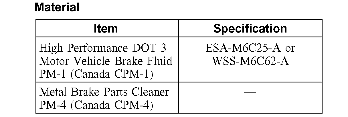

WARNING: Use of any other than approved DOT 3 motor vehicle brake fluid will cause permanent damage to brake components and will render the brakes inoperative. Failure to follow these instructions may result in personal injury.
WARNING: Brake fluid contains polyglycol ethers and polyglycols. Avoid contact with eyes. Wash hands thoroughly after handling. If brake fluid contacts eyes, flush eyes with running water for 15 minutes. Get medical attention if irritation persists. If taken internally, drink water and induce vomiting. Get medical attention immediately. Failure to follow these instructions may result in personal injury.
CAUTION: Brake fluid is harmful to painted and plastic surfaces. If brake fluid is spilled onto a painted or plastic surface, immediately wash it with water.
CAUTION: Do not allow the brake fluid to come in contact with the adhesive backing on the brake pads. If brake fluid is spilled onto the brake pads, new pads must be installed.
CAUTION: Use only specified brake parts cleaner. Use of other cleaners may leave a residue on the brake caliper preventing the brake pads adhesive surface from bonding with the brake caliper.

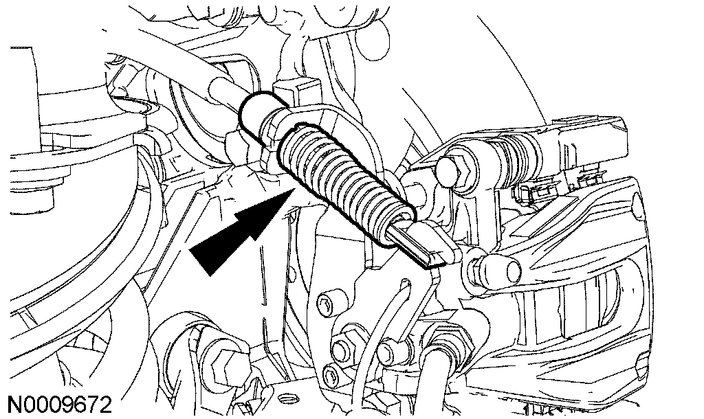

2. Release the tension on the parking brake cable.
3. Disconnect the parking brake cable end from the brake caliper lever and release the parking brake cable retainer from the caliper bracket.

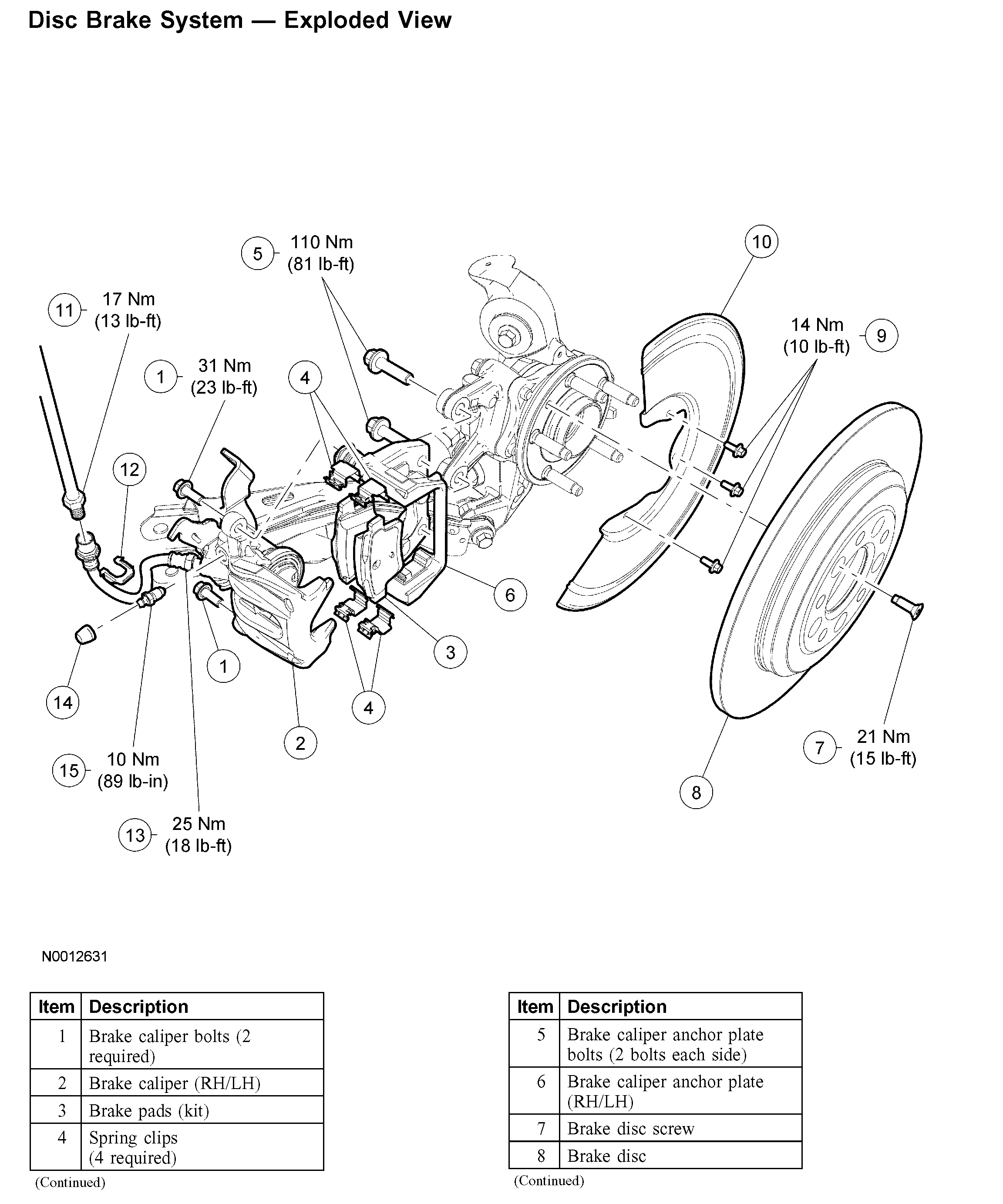

Remove the 2 brake caliper anchor plate bolts and discard. Position the brake caliper anchor plate, brake caliper, and brake pads aside.

7. Remove and discard the brake pads and spring clips from the brake caliper anchor plate.

1. NOTE: The LH caliper piston turns clockwise and the RH caliper piston turns counterclockwise.
Using the special tool, compress the brake caliper piston into its cylinder.

Install the new spring clips and brake pads.
5. Position the brake caliper and install the 2 bolts.
^ Tighten to 31 Nm (23 ft. lbs.).
6. Connect the parking brake cable to the brake caliper.
7. Reload the tension on the parking brake cable.

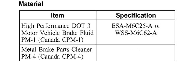

Let me know if this helps. If the problem is you cannot fit the pad into the mount, then make sure to clean any rust or corrosion from under the spring clip. Use a file to do it. If you can fit the pads into the mount, but there is not enough room to fit over the rotor, then you need to depress the caliper piston further.
