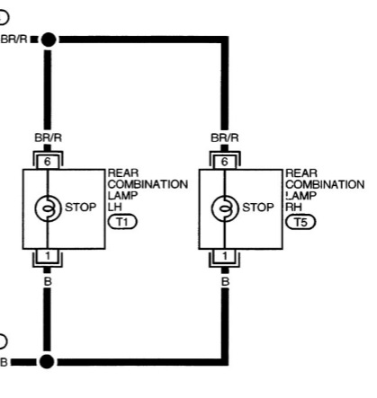

The brake light on the back of cab works, but the ones in the tail light do not.
Tuesday, September 19th, 2017 AT 10:15 AM
JDL
MECHANIC
16,098 POSTS
In the diagram the top wire is voltage, the bottom one is ground. Use a test light and check them both, voltage and ground.
