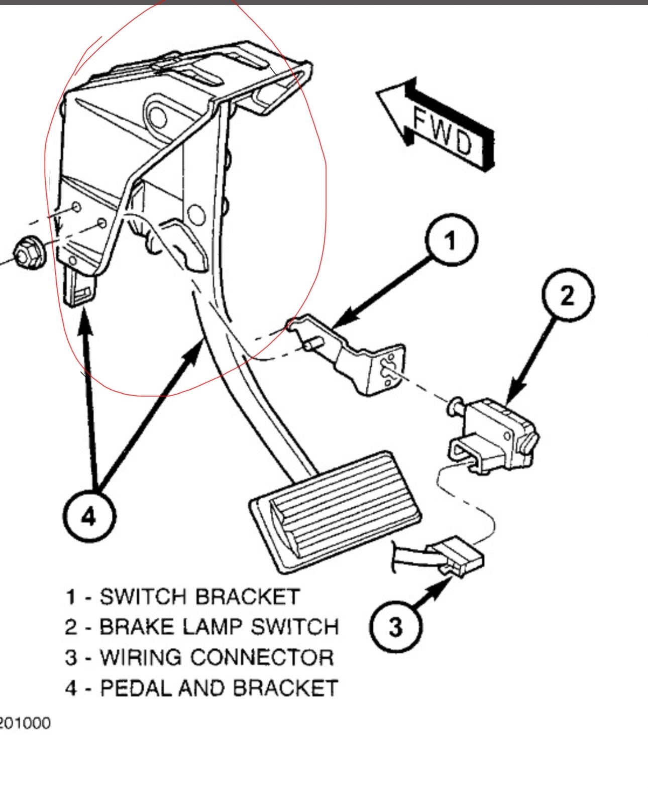

I had my brake power booster replaced and then the brake lights would not go off. The brake light switch plunger was stuck down. Purchased a new one but there is a bracket that it connects to. The bracket is broken. I need to know what the name of that bracket is and/or if it is a part of a larger assembly. I saw a diagram someone put in this site in response to another vehicle I have circled the part in that picture.

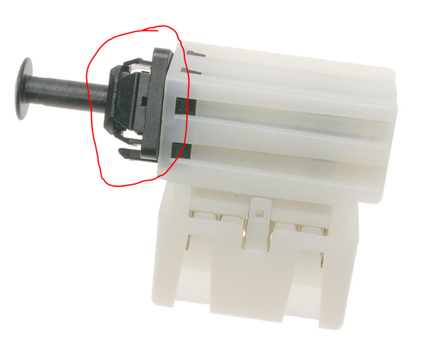

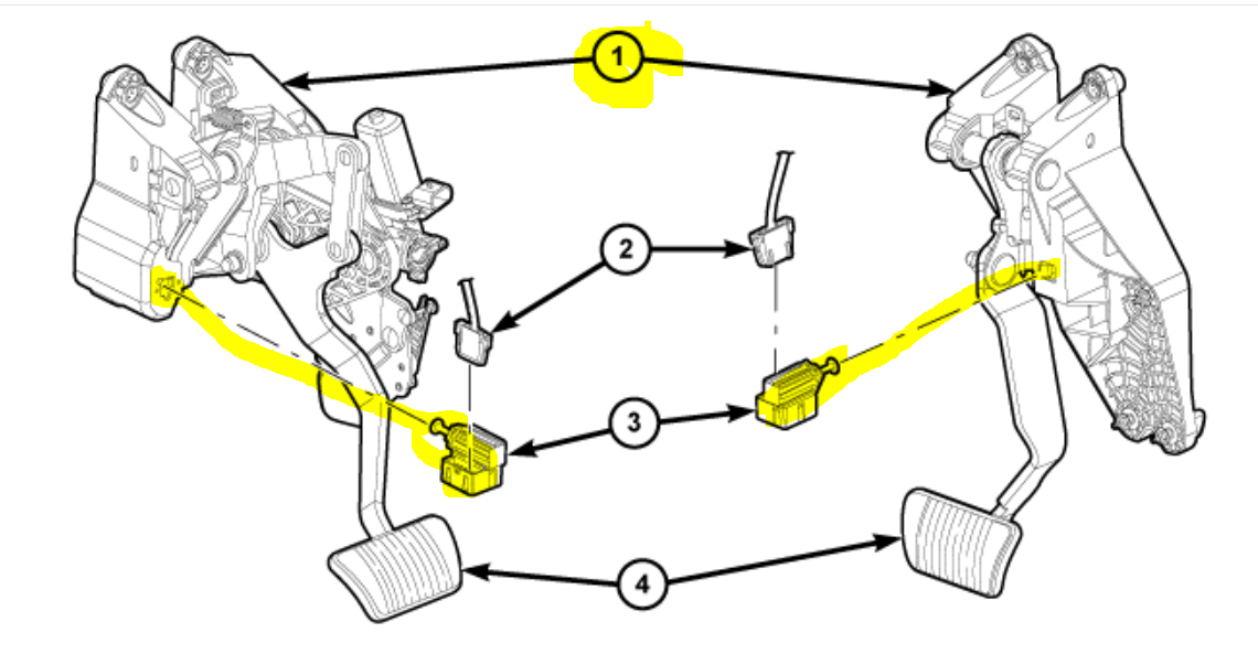

As far as the mount, based on the brake/throttle pedals are adjustable or not, the brake light switch is part of the brake pedal mounting assembly. See pic below of both the adjustable and non-adjustable designs.
The brake light switch should fit into a square cut out in the assembly and is secured by a 1/4 turn. Some are removed with a 1/4 turn and others clip into place.
The pic you have above isn't from a 2014 van. If possible, let me know what link you found that picture on.
See pics below. Note: Pic 2 shows the switch. I circled the square portion I mentioned.

That one was from an older model I just saw it from a bad angle it looks similar to that. That post was about a 2002. I’m going to get more information on it tomorrow but here is the link to that post: https://www.2carpros.com/questions/2002-chrysler-town-and-country-brake-light
Nov 11, 2024 at 8:05 PM
  • 110,193 POSTS
That is correct. I thought it looked odd when I saw it. Let me know what you find or if I can help.
