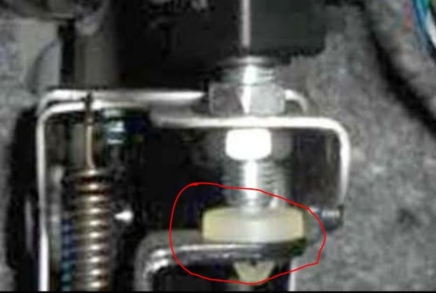

Brake lights stay on all time
2009 KIA SEDONA
70,000 MILES • 3.8L • 6 CYL • 2WD • AUTOMATIC
YONIARMON79
Even when the car is turned off. The rubber bumper that strikes against the brake light switch has broken.. where can I get a new one?
Sep 2, 2019 at 5:05 PM
  • CAR REPAIR CONTRIBUTOR
  • 110,193 POSTS
Welcome to 2CarPros.
I attached a picture below and circled the part I believe you are referring to. If I am correct, that part will be specific to a dealer. However, you may find something that will work at a parts store. Often times they have a section of retainers, clips, and so on. Something there may work because it just clips onto the bracket.
Let me know if this is the correct part.
