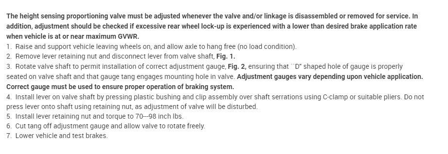

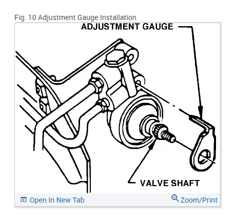

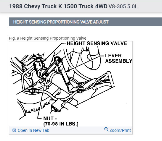

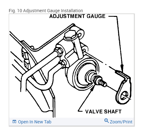

I don't like the feeling of a low pedal either. Are the rear brakes fully adjusted? That can cause the low pedal but not the bleeding issue.
I came across a height-sensing proportioning valve and attached adjustment directions below. By any chance, do you have this set up?
