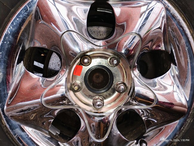

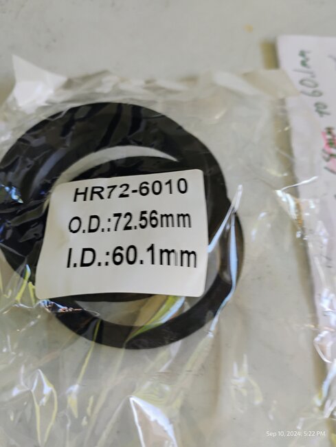

Great news, I went to a tire -custom rims shop and they measured the rim, compared it to what readings on the Tacoma information and it will work. They sold me the hub centric rings too. See size -went from 60.1 to
72.56 on hub ring. Is plastic ok vs aluminums. I'll get offset difference..
The difference is close enough on inner measure.

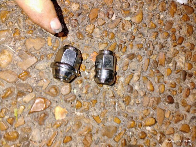

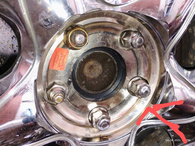

Rings for perfect. What type of lug nuts are better for this rim. Ones that are bigger in pic or skinnier. There is a bigger hole for studs in this rim than the OEM rim.I've seen some nuts that go inside rim too but may not need them.

Which type of nut on pic would give me a better fit, wide one or thin one?

I would go with the lug nut on the left. It has more of a bite on the rim.

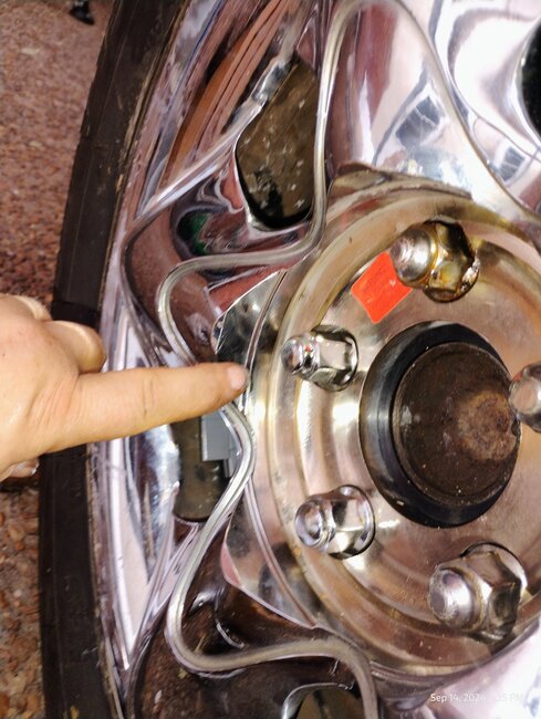

Thanks. I gave it a test run an it did great but at 50 55 mph a slight shake in steering wheel like it slightly wiggles a hair. Is that because it's 16 on rims an not 15 an higher or is that a balance issue?
Front 2 are 215 70 16 same as last but 16. Rear are 225 70 16 last were 215 70 15. All just mounted and balanced.I used those bigger nuts an got em at the tightest normal tightening you would any tire. Hub centric rings.
