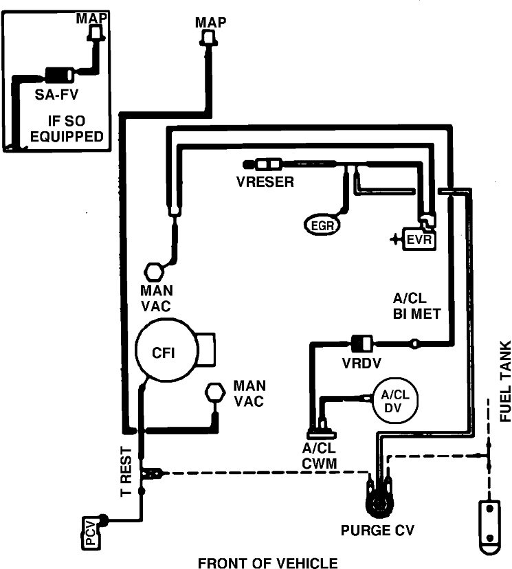

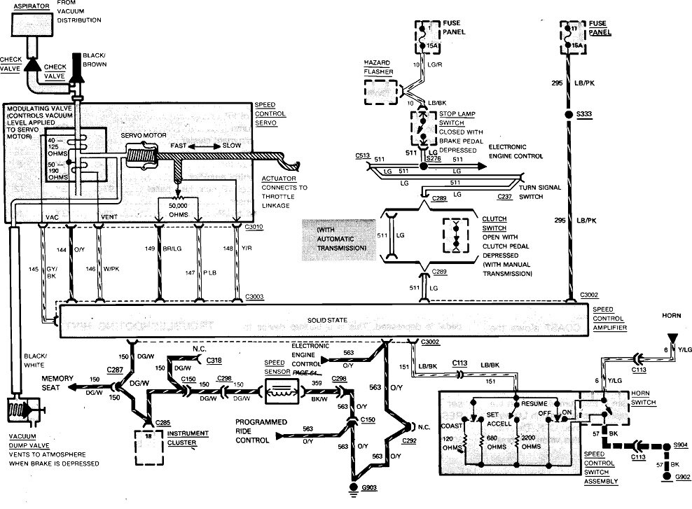

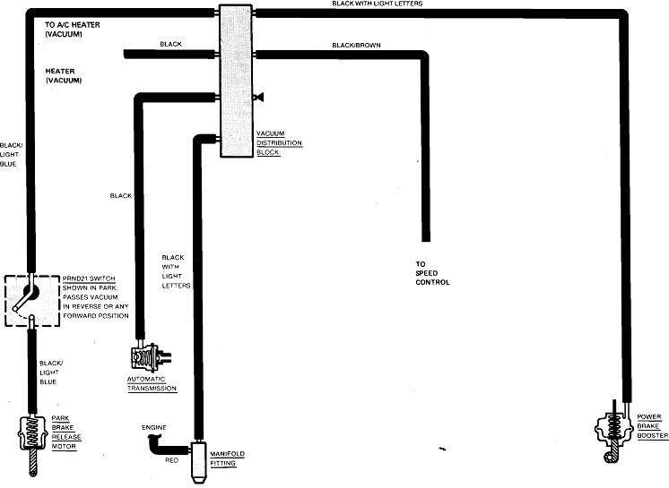

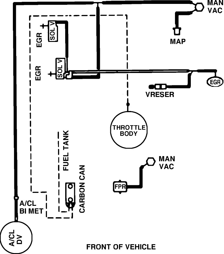

I need to track down all the lines
Thursday, January 8th, 2026 AT 12:56 PM
CARADIODOC
MECHANIC
34,481 POSTS
This first diagram is for Brakes and Transmission. Second one is for the cruise control system. Last two are for two versions of the emissions system, CFI and EFI.
