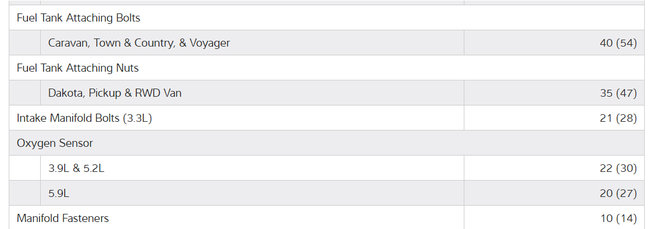

Need to replace the four bolts holding the fuel injection throttle body to manifold. where can i get information on the specs and where to buy them? i live by Tulsa OK.
Apr 2, 2019 at 8:16 PM
SCGRANTURISMO
  • CAR REPAIR CONTRIBUTOR
  • 4,897 POSTS

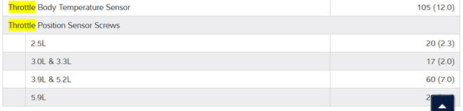

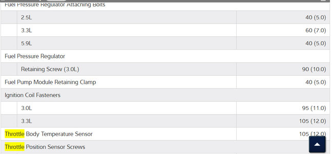

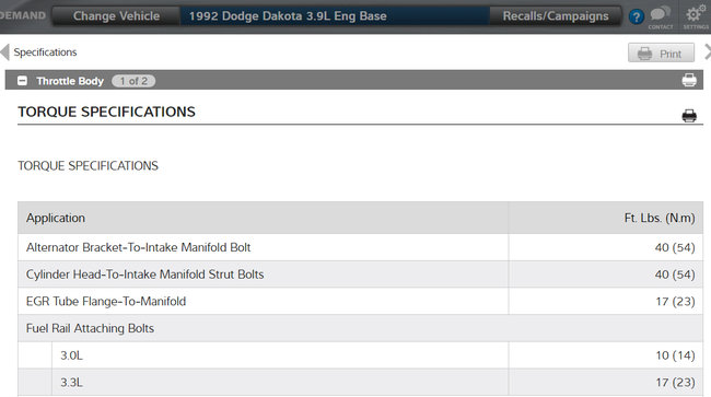

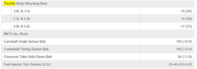

The bolt size you are looking for is M6X1.00X45.00. The best place to buy them at be at your local hardware store. Most hardware stores have a great fastener section and you can pick them up fairly cheap. I have also included in the diagrams for you down below all the torque values for your vehicle to make sure that they are torqued down tight and to specs.
