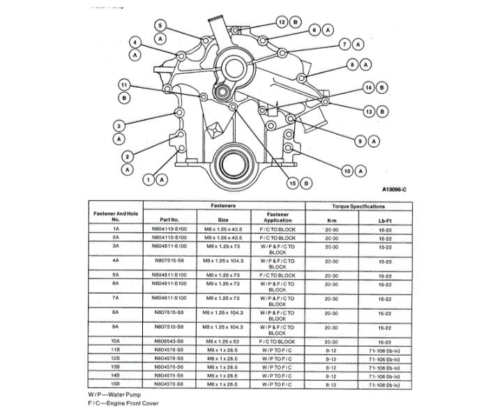

Different bolt types need diagram layout.

Good afternoon,
What bolt pattern do you need so we can help?

1999 Taurus 3.0 v6 front bracket and water pump vin=1fafp53u1xg326205.

I attached a picture of the front cover with the pump that lists bolt sizes and position.
