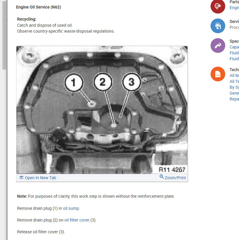

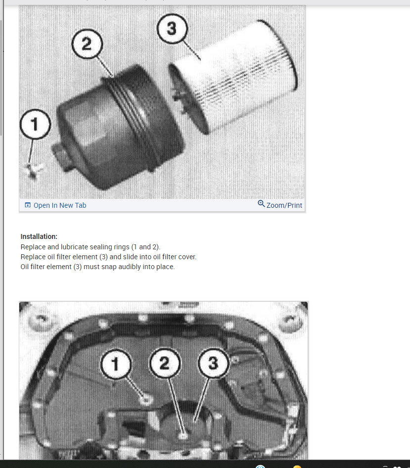

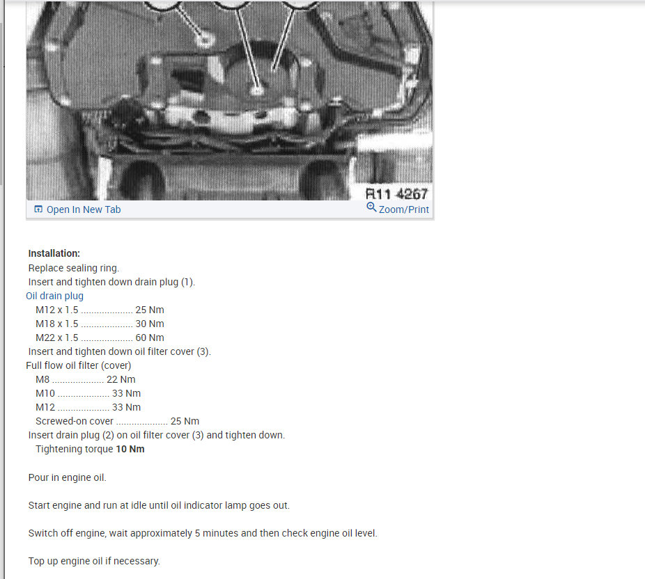

Oil filter change.
Saturday, June 12th, 2010 AT 1:07 PM
MECHANIC
18,907 POSTS
We can help with this. Not only will I provide the process but here is a video on this vehicle on how to do this:
https://www.youtube.com/watch?v=TRtpyZAF_Hg
Here is a guide that will help with this as well:
https://www.2carpros.com/articles/how-to-change-engine-oil-and-filter
Below is the process from the manual as well. Please let us know if you have other questions. Thanks
Images (Click to make bigger)
