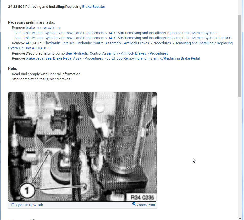

My brake booster is not working. My question is can I do the job myself? Thanks Guys.
Wednesday, June 17th, 2009 AT 4:13 AM
MECHANIC
18,907 POSTS

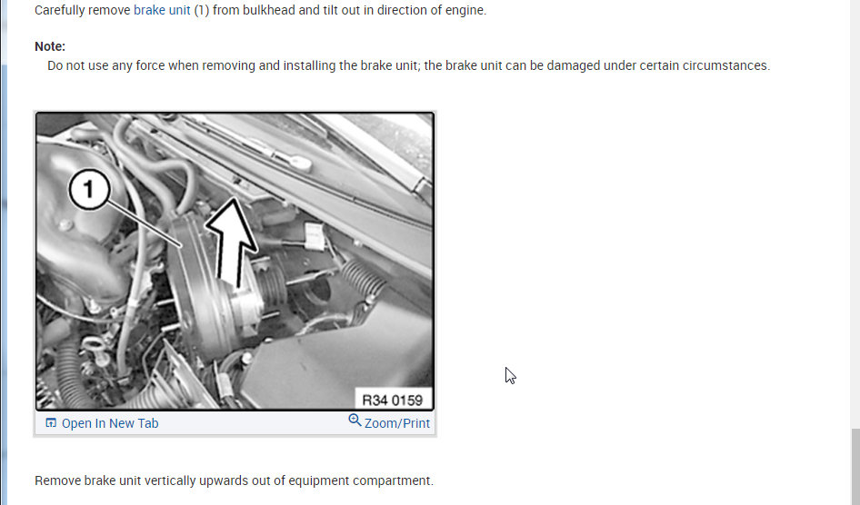

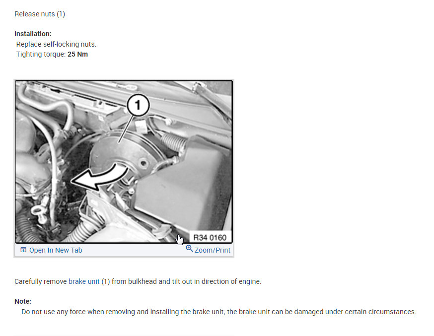

It is not that complicated. I am attaching the info below on how to replace this from the manual.
Please run through this material and let us know if you have any questions.
Thanks
