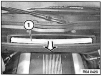

Where is the cabin air filter and how do you replace the filter

2005 BMW X5 (E53) L6-3.0L (M54)
Cabin Air Filter
Replacing Microfilter For Interior Ventilation
*Turn toggle through approx. 90 ° and open cover (1)
*Pull out microfilter for interior ventilation (1) in direction of arrow.
