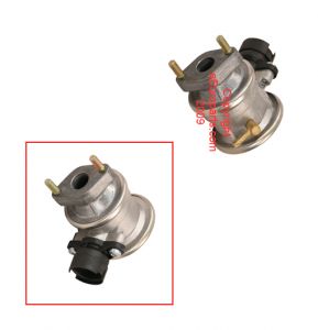

Lets get the facts straight, EGR was not installed on this car. BMW has not used EGR for a long time. What was done, what was replaced and what method was used to pull codes? Generic code readers dont always tell the tale. Have you replaced the pre-cat oxygen sensors yet?

AS A PROFESSIONAL, I TRUST YOU BUT YOU CLAIMED THAT (BMW DID NOT USED EGR VALVE) SPECIALLY ON MY CAR MODEL. AND THIS IS WHAT I HAVE REPLACED IN FRONT OF THE ENGINE ON THE SIDE.

ALSO THIS VEHICLE USED TWO DIFFERENT EGR VALVE: (THE BLACK ONE THAT COVER THE REAR INTAKE MANIFOLD) ALSO CATEGORIZED AS (EGR VALVE). AND THE OTHER ONE PICTURED.

The valve is for the secondary air injection, not EGR. The plate IS the PCV valve on the back of the intake manifold.
