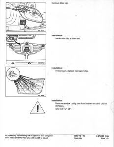

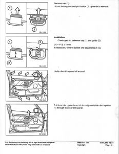

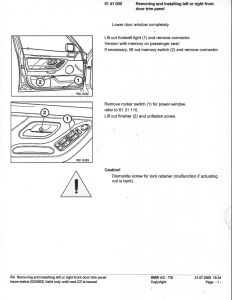

The driver's door won't open from the outside. Would you please advice how can I remove the door panel and fix this problem?

The door lock assembly will require replacement, P/N 51-28-8-235-097
