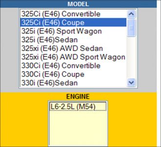

where is the crankshaft sensor located
Saturday, November 15th, 2008 AT 8:03 PM
3 Replies
IMPALASS
  • 3,112 POSTS
Hello

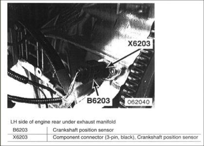

I have provided the info requested. If you need further info please ensure you provide exact vehicle model info. . ..I have attached the various models.
Thanks

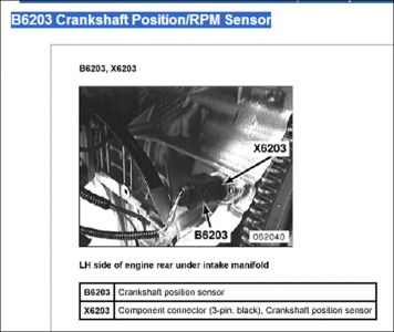

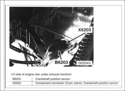

The picture looks correct but the caption says under the exhaust manifold, not so, it's under the intake manifold just below the starter.

Thanks to Dr Hagerty for catching the pic, I found in the book another caption that says under the intake manifold. I attached two pics from the same program area - go with the caption that Doc says. . .. . ..
Hope this helps. . ...
Thanks Doc for your help!
