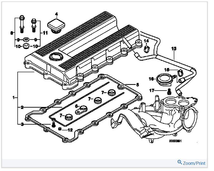

Hi.... I am experiencing a high pitched whistle in my 99 E46 BMW 316i 1.9. It happens once the car warms up after 20 miles or so.... It disappears if you fully press the accelerator but is louder as the car comes down to idle speed. Already changed the idle regulator at the advice of a shoddy mechanic who lied to me that he had fixed the problem. Please please please help... this noise is ruining my life... my vin is aw52308

It sounds like you have a vacuum leak which will make that noise. Here is a guide to help you find it.
It can be the crankcase ventilation system causing it as well.
Please run down this guide and report back

11157501567 is the part you need, it is the crankcase vent valve #16 in the diagram below.
