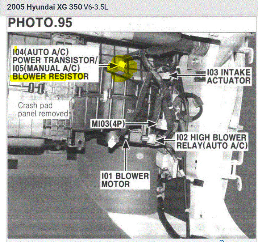

Wheres is it located on my car?
Friday, July 17th, 2020 AT 7:26 PM
MECHANIC
110,192 POSTS
It is located under the dash on the passenger side and is mounted on the HVAC box. I attached a picture of it's location.
Let me know if that helps or if you have other questions.
