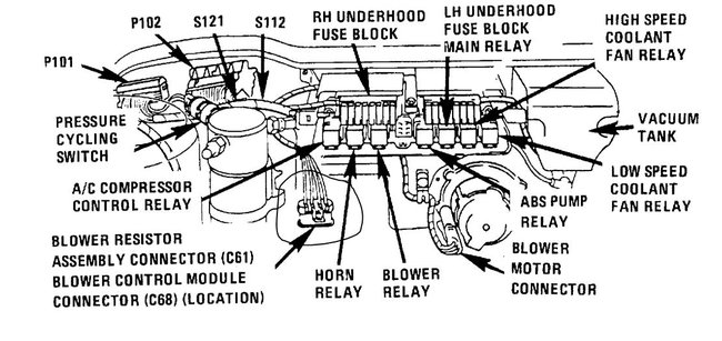

Not sure if relay or if the module. I don't know how to tell.

Good afternoon,
This sounds like a blower resistor shorted to power. It will not allow the blower to turn off.

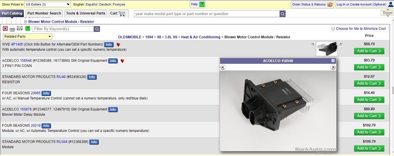

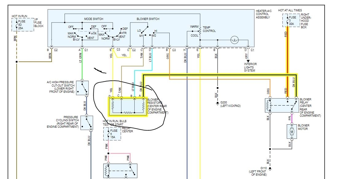

Thank you. It didn't shut off for 5 hours then went off. I was going to try and replace the relay. Is that what you are suggesting?
Tuesday, November 12th, 2019 AT 3:54 PM
MECHANIC
52,796 POSTS
No, the blower resistor is what I suggested.
