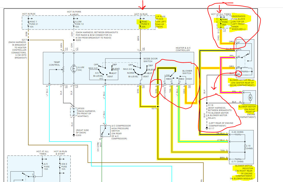

Since my blower motor is new and also the bm resistor, i am going to replace the blower motor relay, because when i looked at it under the hood, at the firewall, i seen that some of the wires are exposed and show the copper wiring. I got one from Auto Zone and the one is the same, except, the 6 wires are a heavy gauge (16 gauge) wires, compared to the one that is in the harness which looks much thinner, very thin. Is it okay to use the heavy gauge that can with the new Santech A/C part?? The Duralast part relay 19265. I just wanted to make sure that nothing goes wrong, because after i do the wiring splicing, I am going to use heat shrink on all the wire to protect, what do you think? I am open for all answers, and God bless for all the help to everyone. Hope to hear from you soon.
Jun 18, 2024 at 12:34 PM
  • CAR REPAIR CONTRIBUTOR
  • 110,190 POSTS
If the new part has heavier gauge copper wires, it's like having extra money in the bank. It is actually less likely to melt down.
I like the idea of the heat shrink. That is a great idea and I strongly recommend it.
If you are using butt connectors to join the two wires together, make sure the wires are secure in the connector before installing the heat shrink.
Now, if you look below, I attached the wiring schematic for the blower motor. I would recommend checking the HVAC fuse under the hood first. If that is good, then check the HVAC fuse 9 in the vehicle. Note: The fuse under the hood will have power at all times and the interior one only has power when the key is in the run position. Confirm they are good and let me know the results. If they are, we can continue the diagnostic process.
Let me know if that helps or if you have other questions.
See pic below. I highlighted or circled where the most likely problem would be.
