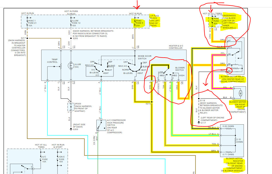

Since my blower motor is new and also the bm resistor, I am going to replace the blower motor relay, because when I looked at it under the hood, at the firewall, I seen that some of the wires are exposed and show the copper wiring. I got one from Auto Zone and the one is the same, except, the 6 wires are a heavy gauge (16 gauge) wires, compared to the one that is in the harness which looks much thinner, very thin. Is it okay to use the heavy gauge that can with the new Santech A/C part? The Duralast part relay 19265. I just wanted to make sure that nothing goes wrong, because after I do the wiring splicing, I am going to use heat shrink on all the wire to protect, what do you think? I am open for all answers, and God bless for all the help to everyone. Hope to hear from you soon.

If the new part has heavier gauge copper wires, it's like having extra money in the bank. It is actually less likely to melt down.
I like the idea of the heat shrink. That is a great idea and I strongly recommend it.
If you are using butt connectors to join the two wires together, make sure the wires are secure in the connector before installing the heat shrink.
Now, if you look below, I attached the wiring schematic for the blower motor. I would recommend checking the HVAC fuse under the hood first. If that is good, then check the HVAC fuse 9 in the vehicle. Note: The fuse under the hood will have power at all times and the interior one only has power when the key is in the run position. Confirm they are good and let me know the results. If they are, we can continue the diagnostic process.
Let me know if that helps or if you have other questions.
See pic below. I highlighted or circled where the most likely problem would be.

Okay, installed the new blower motor relay, new bm was installed 2 months ago with the new resister, all fuses are ok, started the blazer, turn on the HVAC to A/C, works, but, but. Still getting very little air to the top vents for the a/c. My son the Mechanic all along has been telling me that it's a leak somewhere in the heater box, and he wants both of us to remove the dash again, only one hour for both of us to do it. I still say its a door that wont open to let the air blow freely to the vents, and I always try the easy short cuts first, then hit the major headache. I have a camera endoscope and was going to check all possible ways and means to see if the door(s) are not opening. I know the one in the glove box is working, but I believe there is a another one or two in the box. Im the old school stret mechanic and have to find why or how come its broke and my son knows this but he likes to use his smarts on me, just to break um. So, im open for this last conclusion on your answers and I hope drop down the dask isnt the last, but I believe it will be to end this issue. Any thoughts?

Is it only the vents that have little pressure? In other words, does the defrost or floor heater work normally? Also, if there is a leak in the box, I would think you would feel the leak from under the dash.

Yes, only the vents and defrost and floor have very little air blowing, your call.
Friday, June 21st, 2024 AT 8:25 PM
  • 110,192 POSTS
I think it needs to come out. Something is likely either broken at the blend door or has come apart. I wish I had an easier answer. If you can't see anything, the only thing I can think of is to take it further apart. If your luck is like mine, you'll find a mouse nest or something. LOL
