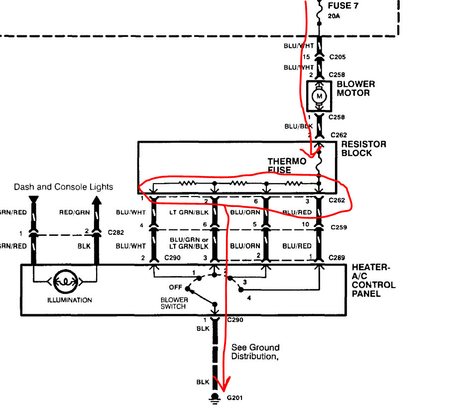

An aftermarket alarm was wired in prior to my purchase of the vehicle. It was a disaster of a wiring job, so I removed and fixed all wires to factory. Upon fixing the steering column wiring, I noticed a red/black wire from the turn signal switch (which seems to be for the headlights) is completely burnt. The wire is still making contact and working but the blower motor relay has completely burnt terminals. The blower motor does not work and all the wires to the motor and resister have signs of over heating.

Okay. Thank you for the reply. I wasn’t sure if the blower motor relay was some how connected to the poor wiring job of the aftermarket alarm since the turn signal switch wire was burnt as well.
Upon more diagnosing, I found that all wires coming from heater switch are grounded when key is on, along with all wires coming from heater resistor except for the blue/black wire coming from resistor to blower motor plug. It is completely dead.
Wednesday, May 6th, 2020 AT 8:59 PM
  • 110,194 POSTS
I attached a wiring schematic below. If you are checking between the motor and the switch, you should have ground to all. The power to the motor is through the relay to the motor, and then through a resister at the switch. Then ground is after the switch. Is that how you are checking it? As far as the blue/black wire, that should have power. Is there power to the going into the blower motor? If not, check fuse 7 in the fuse/relay box.
Thursday, May 7th, 2020 AT 7:25 AM
JOBYHUX
  • 9 POSTS
Okay, I was looking at it half backwards. Blue/white from fuse to motor has power, so does blue/black wire from motor to resistor. I thought blue/black was suppose to be ground from resistor to motor. So sounds like a faulty resistor.

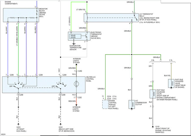

One more issue. Upon further diagnosing of the burnt terminals on the heater relay, I took the fuse block apart and the heater relay wires have been cut off completely. There is no sign of the original wires to the heater relay, so I will tear into the wire loom to hunt them down. Do you have a wiring schematic of how this relay is to be wired?
Thursday, May 7th, 2020 AT 8:03 AM
  • 110,194 POSTS

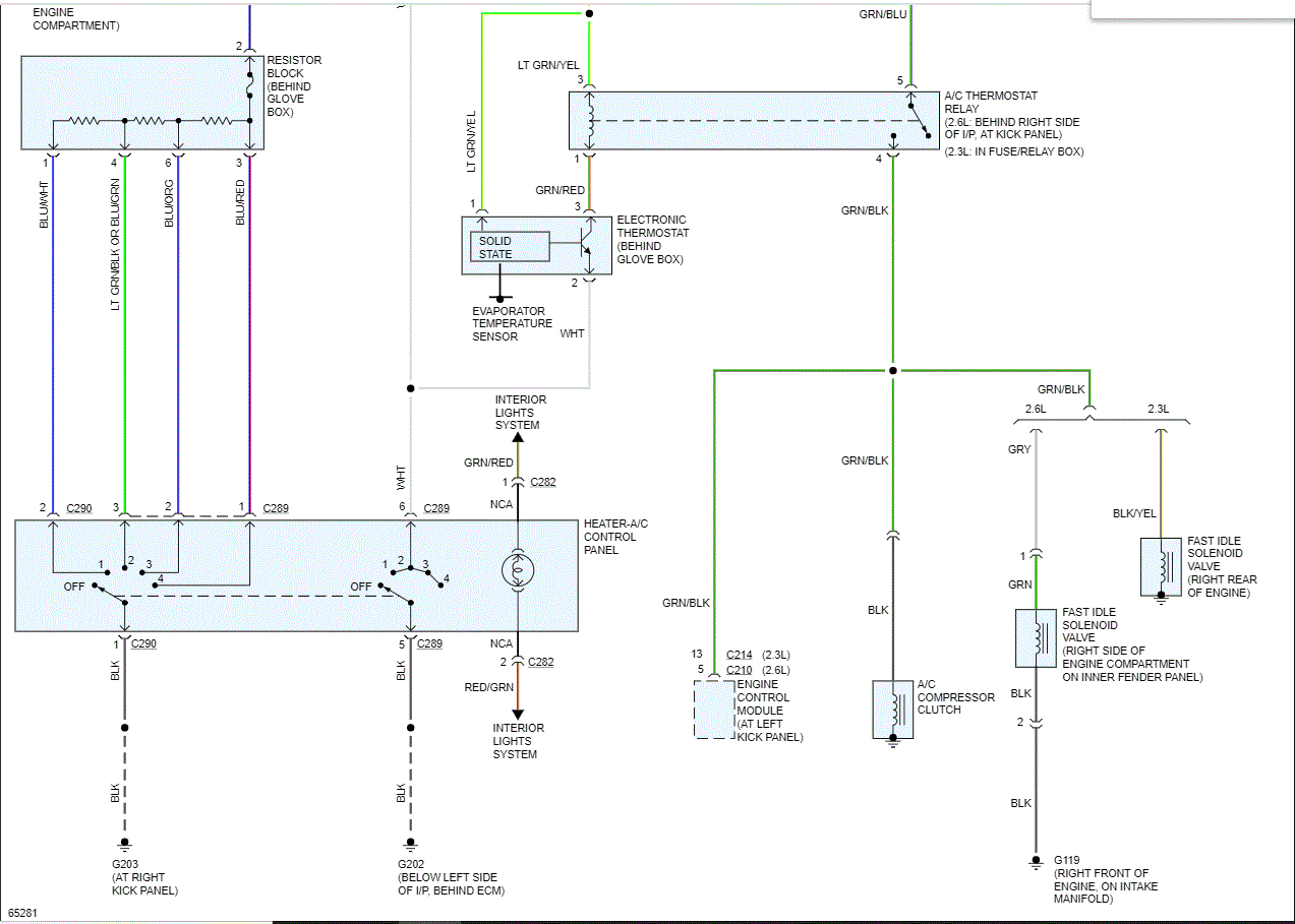

I attached everything I have on the wiring for this circuit. Let me know if it helps.
Thursday, May 7th, 2020 AT 8:58 AM
JOBYHUX
  • 9 POSTS

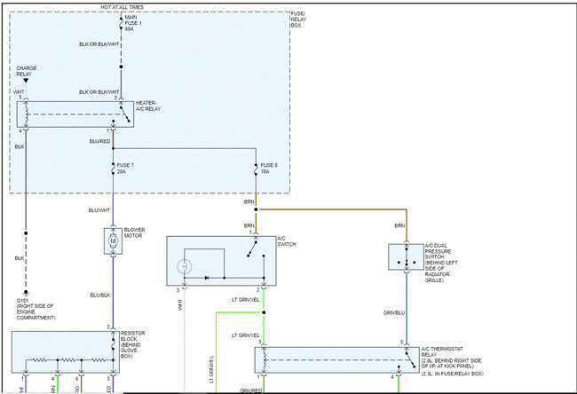

From what I can tell, the heater and A/C relays were linked together from the factory. The blower motor must have faulted and caused the heater relay to burn up, so someone cut the wires from the heater relay, put on new terminals (which are; white, black/white and blue/red) then plug them into the A/C relay.
Thursday, May 7th, 2020 AT 10:19 AM
  • 110,194 POSTS
Wow. Where do we start. If they took power from the A/C relay, the only time the blower motor would work would be with the A/C on. (I think? I'm trying to picture what has been done.)
Are you able to rewire it using the schematics I provided?
Thursday, May 7th, 2020 AT 9:06 PM
JOBYHUX
  • 9 POSTS
I could but I’m not sure how the heater - A/C relays were originally connected together. My local junk yard only has one pick-up but it’s carbureted, so the wiring under the fuse block is different. The blower motor on my truck is still getting power but from the main fuse#2, which is a 30a. From what I can tell, that is factory set up, just missing the relay in between. The heater relay was suppose to get its power from main fuse#1, which is a 60a but all those wires are now on a/c relay. So I guess the question would be, what all did the A/C relay have on it originally?
Thursday, May 7th, 2020 AT 9:48 PM
  • 110,194 POSTS

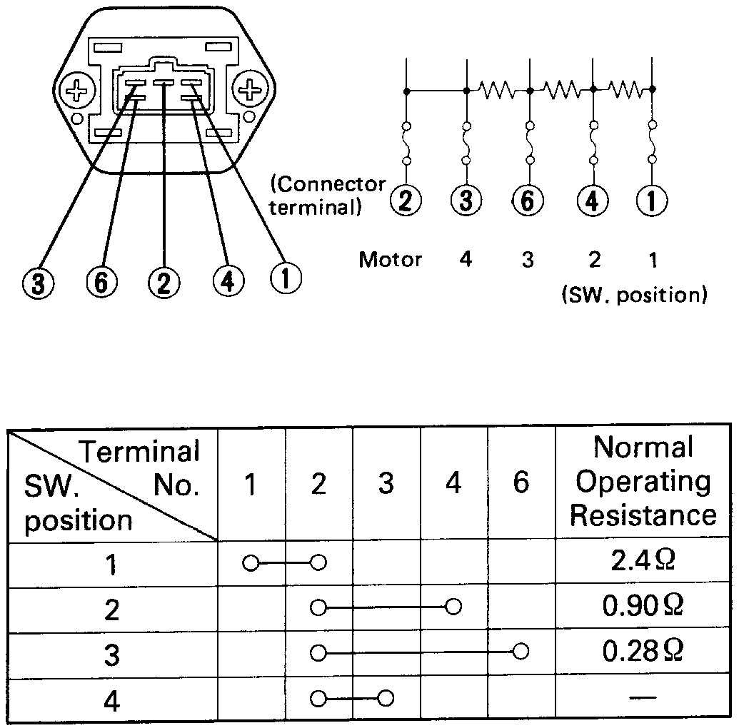

No, there is no power out of resistor. Not even high speed. I took the switch apart and everything seems to be normal. I’ll replace the resistor and see what happens next.
Sunday, May 10th, 2020 AT 7:34 AM
  • 110,194 POSTS
That sounds like where the problem is. Since you have power in and nothing out, something has failed.
I don't know if you want it, but I attached a pic below indicating how to check resistance in the relay. You may want to do this prior to replacement.
Let me know how things work out for you.

The wiring diagrams definitely helped. Now I know where the wiring issue it. Maybe it’ll all work fine without the heater relay. This truck is more of a restoration project than a everyday vehicle, but I still would like it to be correct. So thanks again!
