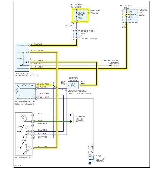

No power at fan. All fuses and relays checked.
Friday, May 24th, 2019 AT 8:45 AM
MECHANIC
52,796 POSTS
Good afternoon,
I attached a diagram for you to view. The power to the blower comes from the relay. Can you do some voltage tests at the relay with a test light or volt meter?
