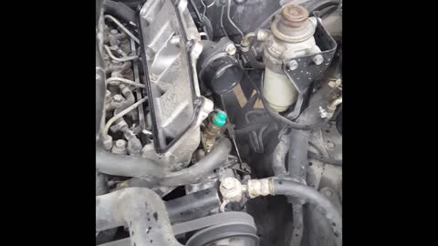

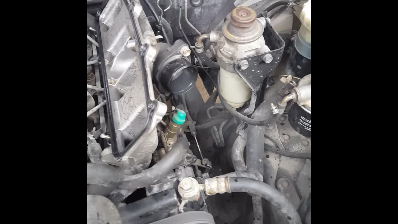

I would like to know if it is normal to have an engine with blow by? It does not consume any oil.

Good morning,
Blow by is normal. Your PCV system is what controls the crankcase pressure from compression passing the rings.
Excessive amounts is not right if the PCV system is clogged or the piston rings are worn out.

Thanks for your reply. Is it normal to have this blow by? Engine runs normally and fine without any oil consumption etc.

That is not bad.
Clean out the PCV system.
