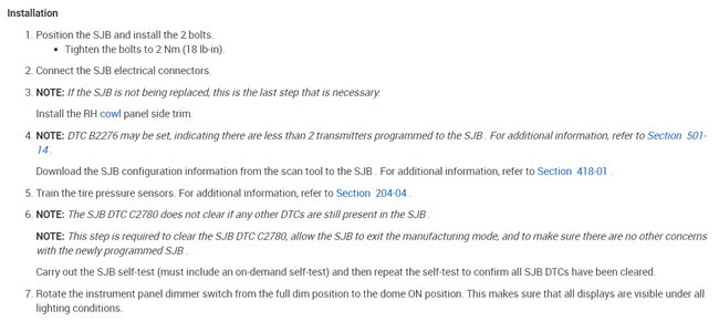

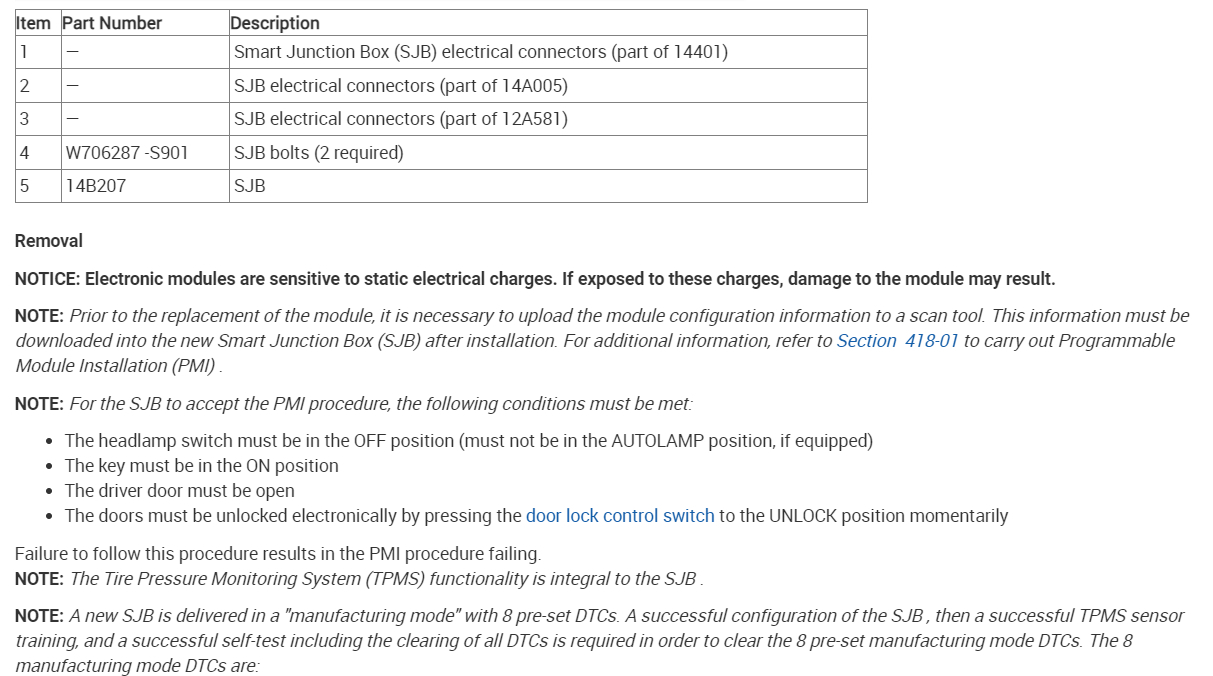

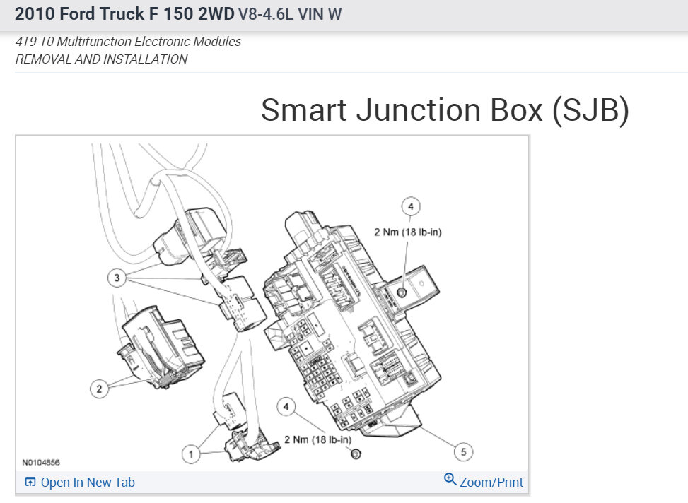

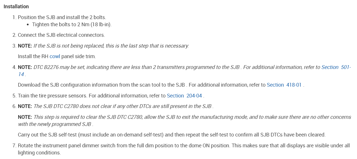

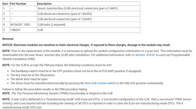

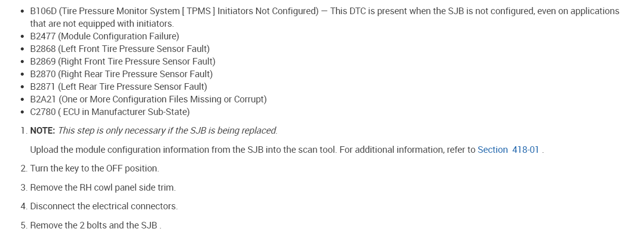

Yep, I have seen the microprocessor and out inside the SJB (smart junction box) and cause this issue, to be sure we should do a CAN scan. You can get a CAN scanner (Controller Area Network) which will work on most cars from Amazon.
https://youtu.be/u-4syLc-ifQ
Here is how to change out the SJB, you can get a preprogrammed unit by searching Google or Ebay. Check out the images (below). Please let us know what happens.

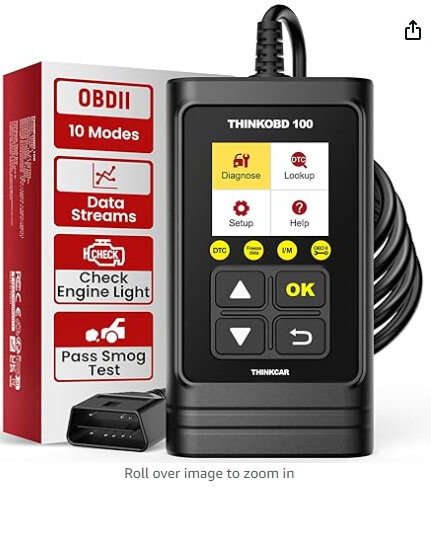

Well, I got it today and scanned it and there were no DTC issues. Any other ideas?
Tuesday, October 3rd, 2023 AT 2:49 PM
KEN L
  • MASTER CERTIFIED MECHANIC
  • 55,097 POSTS
Can I ask which scanner you have?
Wednesday, October 4th, 2023 AT 8:04 AM
BOMAHONY
  • 13 POSTS
It is THINKOBD 100.
Wednesday, October 4th, 2023 AT 8:08 AM
BOMAHONY
  • 13 POSTS
Right here.
Wednesday, October 4th, 2023 AT 8:10 AM
KEN L
  • 55,097 POSTS
Yep, it says CAN but it does not do it. please read these:
https://www.amazon.com/product-reviews/B083F65T8Q/ref=acr_dpx_hist_1?ie=UTF8&filterByStar=one_star&reviewerType=all_reviews#reviews-filter-bar
Here is the one we recommend:
https://amzn.to/3ZYCA1P

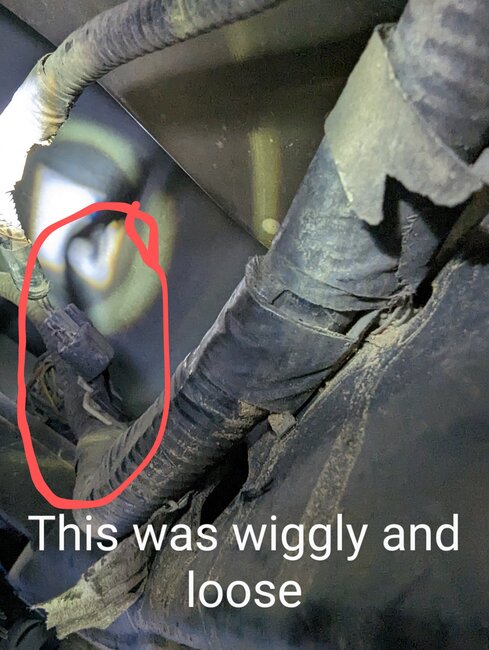

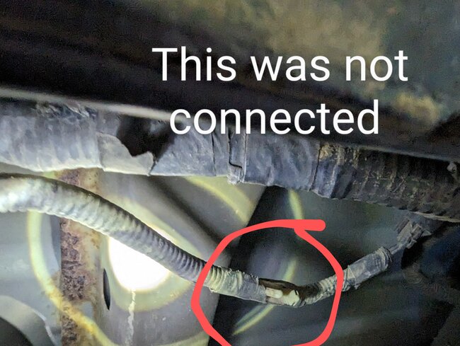

Okay, so here is the current update. Sorry it took so long but I ended up crawling under the truck and following the wires. I found some wires around the spare tire. I wiggled the wires and now it's working normal again.

I would lower the spare tire to see if the wiring harness is catch up or rubbed through. If you find damage can you please upload an image?

These are the 2 things I messed with. They both are against the side beam.
Monday, October 16th, 2023 AT 6:15 AM
KEN L
  • 55,097 POSTS
Thanks for the images :) I don't see that being plugged into anything?
Monday, October 16th, 2023 AT 9:37 AM
BOMAHONY
  • 13 POSTS
Yeah, I have no clue what that goes to, but it's a log wire with a lot of slack.
Monday, October 16th, 2023 AT 10:03 AM
BOMAHONY
  • 13 POSTS
Also, I forgot to mention that I replaced fuse 72 - Auxiliary power point (Rear). That brought power to the back, but the blinkers were still on speed. Then I went down and moved those wires and bam everything is working now.
Monday, October 16th, 2023 AT 10:34 AM
KEN L
  • 55,097 POSTS
It sounds like a bad connection inside the harness, or you have a loose ground at the rear of the truck near where you are moving the harness around.
Tuesday, October 17th, 2023 AT 9:14 AM
BOMAHONY
  • 13 POSTS
Okay, sorry, it took so long but I was able to unplug the connector to the hitch/rear bumper sensors and that seems to have fixed the issue and not the rear sensors don't work but the lights work in the rear. So, I am counting this as a temporary win.
