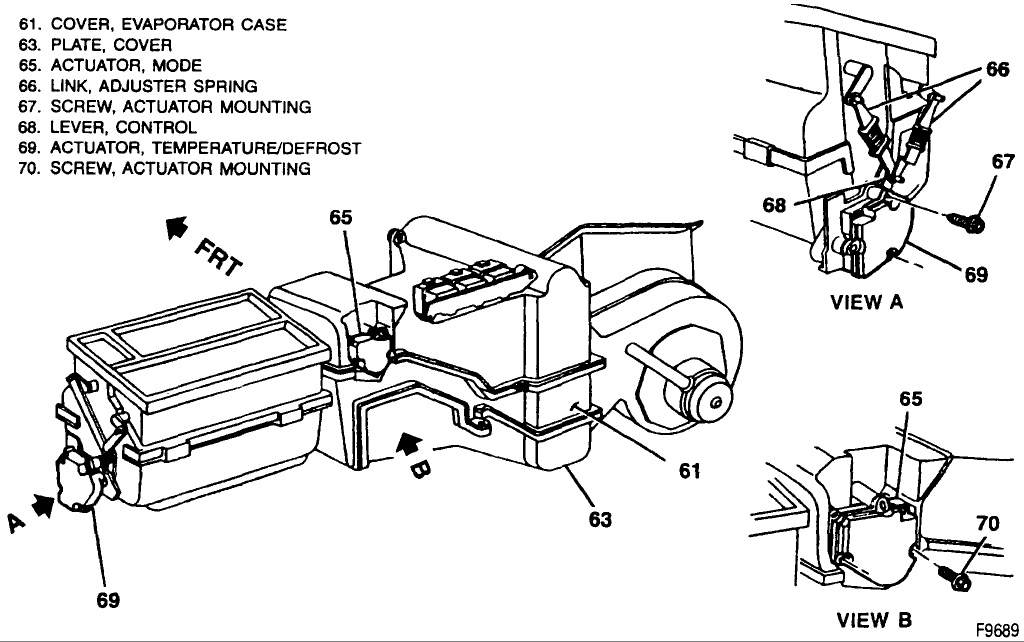

I am looking for a way to put on the blend door actuator
1993 CHEVROLET SILVERADO
200,000 MILES • V8 • 4WD • AUTOMATIC
ALISHA PURCELLA
I am looking for a way to put on the actuator, but i cannot find the mounting bracket.

There is no bracket. There will be three small elevated plastic areas with threaded holes.

The holes so not line up but there is a 14 difference between the actuator and the blower box. The Chevrolet place says the mounting bracket is discontinued.

Then I guess the only option you have left is to find one in a U-pull-it junkyard. I am sure you will have to remove it yourself because the yard will not be bothered with something like that.
