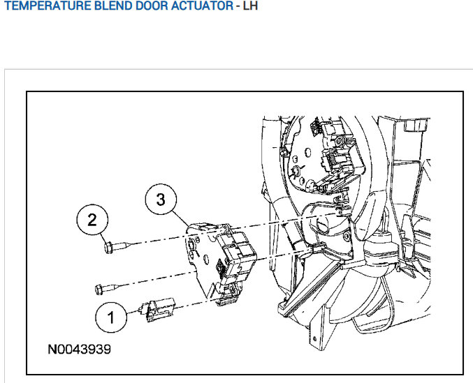

Where is the heater blend door actuator location?
Dec 16, 2024 at 5:00 PM
CHATTY411
Blend door location
Dec 16, 2024 at 5:01 PM
MECHTRIX
  • 382 POSTS
I believe the blend door actuator is in behind the dashboard on the passenger side near the kick panel but up under the dash...barrel
/cylindrical shaped part with cables wires and such ...but as I remember its a job to get to it..so take your time ..good luck hope this helps
Dec 16, 2024 at 5:26 PM
  • 54,511 POSTS
This can be dual zone, so the one on the left side of the passenger compartment will be the one, here is what it looks like. Check out the images (below). Let us know how it goes
