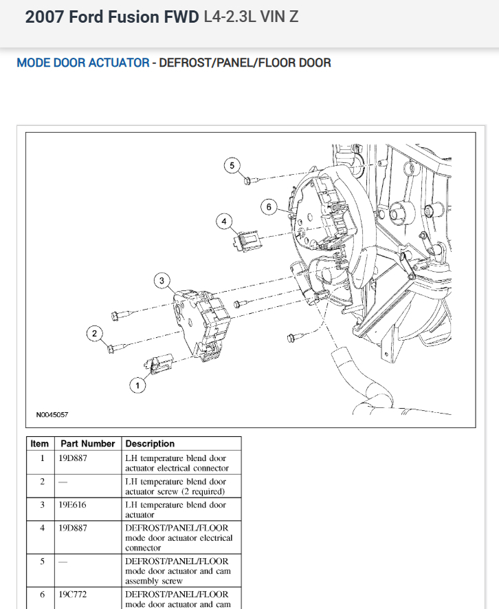

My A/C has been having problems. Will not change settings (defrost etc.,). I changed the blend door actuator by the gas pedal, but I can't figure out where the other one is. Is it going to be very hard to get to?
May 20, 2025 at 9:19 AM
  • 54,503 POSTS

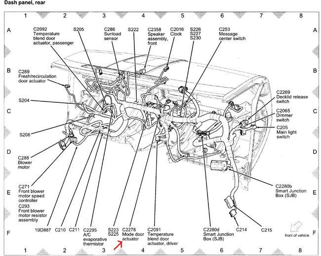

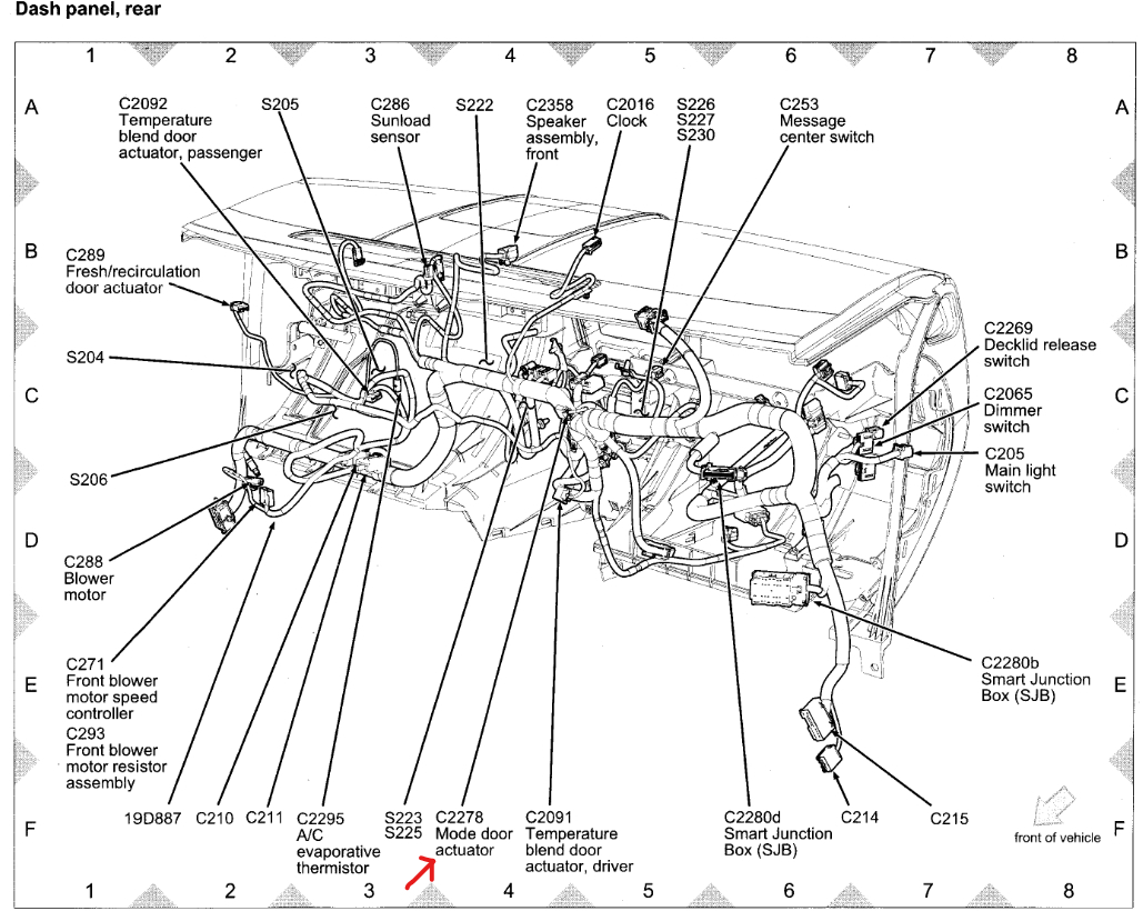

Yep, that would be the mode blend door actuator. Here is the location so you can check it out. Check out the images (below). Please let us know what happens.
May 20, 2025 at 9:49 AM
ATRAIN16
Is it also by the gas pedal?
May 20, 2025 at 10:11 AM
  • 54,503 POSTS
Yes, it is the lower actuator right above the gas pedal.
May 22, 2025 at 9:16 AM
ATRAIN16
I think it is the higher one. The mode door actuator. The lower one is the one I already changed. any hints how to get it out of there?
May 22, 2025 at 10:37 AM
  • 54,503 POSTS
I am sorry, you are correct, it is the higher one :/ I would use a small mirror on a stick and 1/4 drive sockets with a universal to get the mounting screws out. You might need to remove the throttle pedal and any brackets that are in the way. Have a good weekend and let me know if that fixes it.
