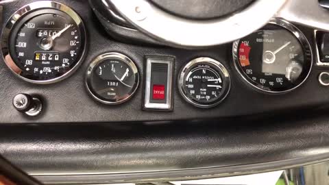

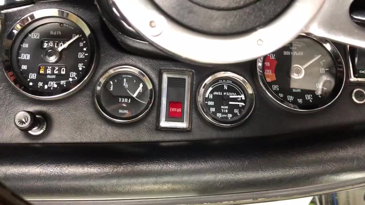

Well when I start the engine cold, the engine sputters, the rpm needle jumps up and down, then after a while the engine starts to get normal when she is getting hot.
Things I checked:
1. Electronic ignition is perfect.
2. Timing is perfect 10°.
3. Compression on all four cylinders is perfect.
4. New spark plugs.
5. The Stromberg DC 150 is cleaned and rebuild.
I really have no clue where to look anymore!
I made a video about the problem.

I realize the carburetor had been rebuilt. However, has the metering needle been adjusted? It sounds like it is dumping fuel. What I would suggest, and it has been awhile since I did one, is to remove the plastic cap at top and locate the orifice adjusting screw down inside the carburetor. Next, turning the screw clockwise will lessen the amount of fuel to the engine (make it a leaner mixture). Turning it counter clockwise will increase the amount of fuel. Based on your video, it sounds like this is where the problem lies. When you make the adjustment, I would recommend no more than half a turn at a time on the orifice adjusting screw. Once you get it to run properly, then there is nothing more than a throttle stop screw to adjust.
Try this and let me know what you find. If you have other questions, let me know. One last thing, make sure there are no vacuum leaks to the engine. Here is a link which shows how to locate them:
Also, this could also be related to the electronic ignition. Let me know if the adjustment works.

Hi Joe, thanks for the tip. I tried it but the problem is still the same. When the engine is cold she sputters and stays at 300 rpm intil the engine is hot. You can smell the gasoline.

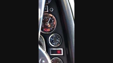

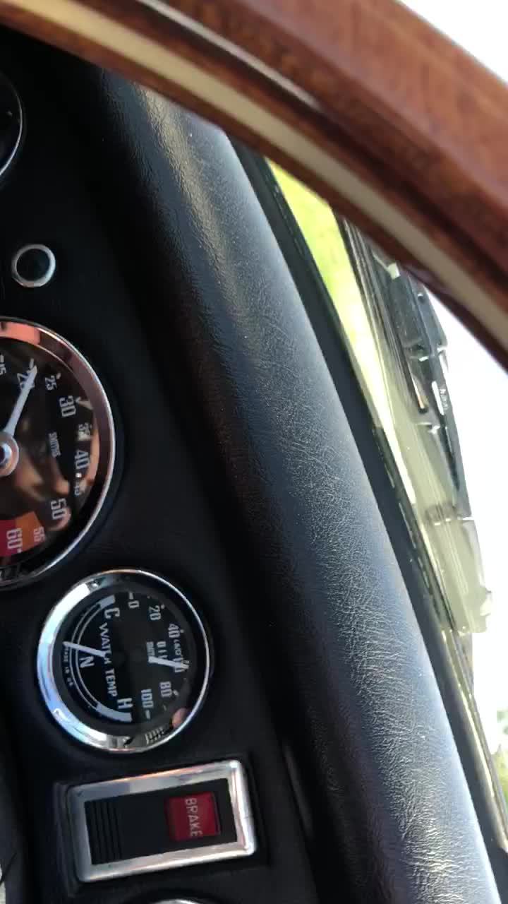

Okay, I am back from holiday. I tried to start it worked. Did a drive came back home let the engine cool and after a hour or two tried to start again and same problem over again, let it warm a little bit and took the car back for a spin. Now what happened after a while is it started to sputter and the needle of the rpm jumped up and down.
Thursday, June 28th, 2018 AT 1:07 PM
JAN JACOBS
  • 11 POSTS
See the video and check rpm needle. Need help cannot find the problem.

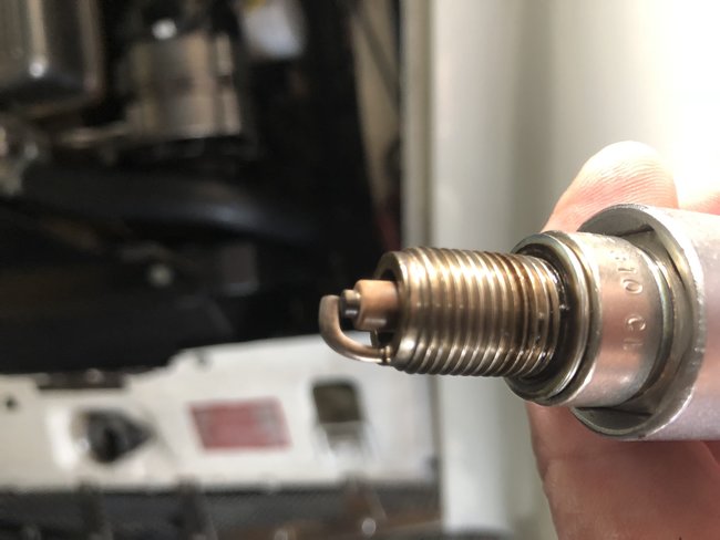

Have you replaced and set the points, condenser, cap, rotor and plug wires? Also, can you pull the new plugs out to see what they look like. Do all cylinders and take a video of them please.
Monday, July 2nd, 2018 AT 12:05 PM
JAN JACOBS
  • 11 POSTS
It is electronic ignition and the color of the spark plugs are very good.

It is good the spark plugs are new. I need to see the electrode color to see if the engine is lean or rich? Also, do you have nex plug wires? Do you install EI? Because that car came with points and condenser.

Hi, here is a picture of the spark plug cylinder four.

I am a little carburetor oriented.
My thoughts on the super videos you sent are either:
A vacuum leak or a fuel issue. I am leaning towards a fuel issue.
This quick test might verify both possibilities.
Get you a sacrificial squirt bottle capable of stream or mist.
Load it with a few ounces of fuel.
I really suggest doing this outside away from other precious things with a first line of defense (big wet towel) and a second line of defense (fire extinguisher).
Remove the air cleaner and crank it up.
Start by misting fuel into the carburetor throat.
Does running improve?
If yes, we may still have a carburetor issue or a vacuum leak.
Before tearing into the carburetor for a problem.
I would rule out the vacuum leak possibility.
Check those hoses for cracks/ being unhooked/ swelled on the ends letting air by.
