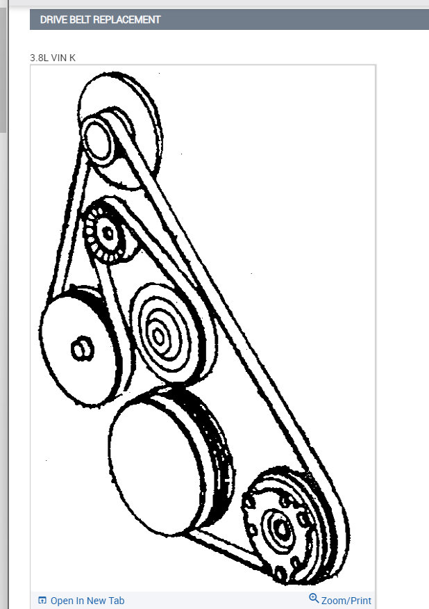

Hoe do I remove the mmotor mount to replce the serpentine belt
Monday, November 29th, 2021 AT 8:50 AM
MECHANIC
18,907 POSTS

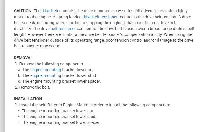

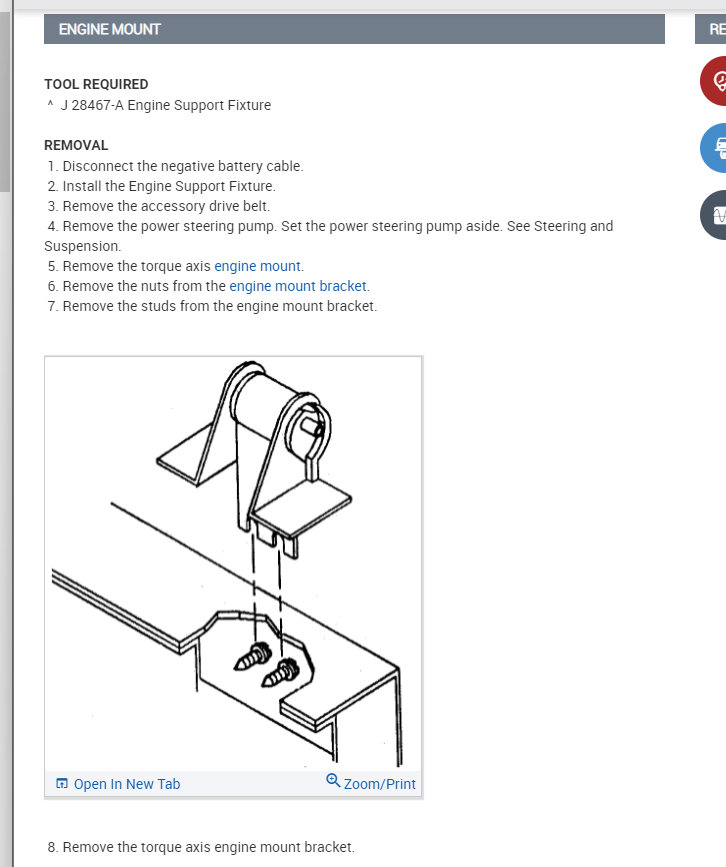

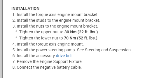

I will attach all the needed info from the manual, but here are two guides that will help with good info:
https://www.2carpros.com/articles/replace-motor-mounts
Below you will find the info from the manual. Please run through this and let us know what questions you have.
