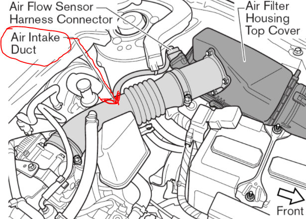

Been told different answers, in locating purchasing part
2005 NISSAN MURANO
134,000 MILES
AZUCENA BRUZON
Hello i am Azucena Bruzon.
The air intake manifold the part that connected to the air filter) at first i read there was a recall, took car to Nissan, was told yes waited when car was returned part wasn't replace the tube before it, which there wasn't any damaged. So next try part stores said its a dealer item. Nissan charging $307.00 just for part when it's a $70.00 piece. Any suggestions?

Hello, I'm Glenn.
There is a recall (R0902) on the Air Intake Duct (pictured below) because of a possible performance issue. There are no other recalls for the Air Intake System. Not sure what you expected to be replaced.
