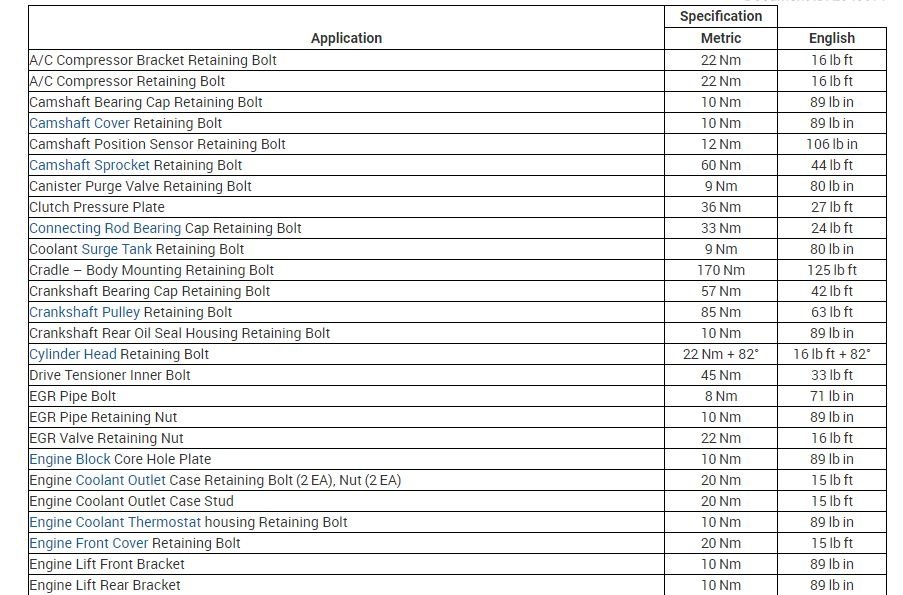

Hi, I need torque settings for the car listed above (800 cc).
Monday, January 4th, 2021 AT 1:40 AM
Good morning,

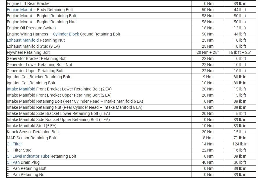

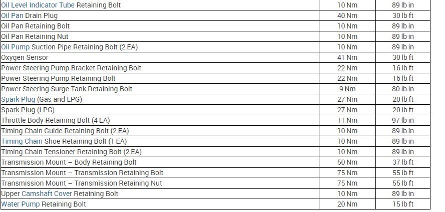

I attached the complete list of torque specs for the engine below for you. Check out the diagrams (Below). Please let us know if you need anything else to get the problem fixed.
