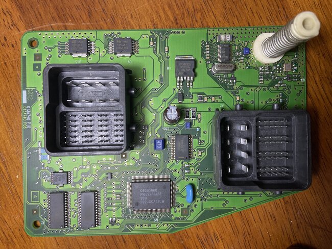

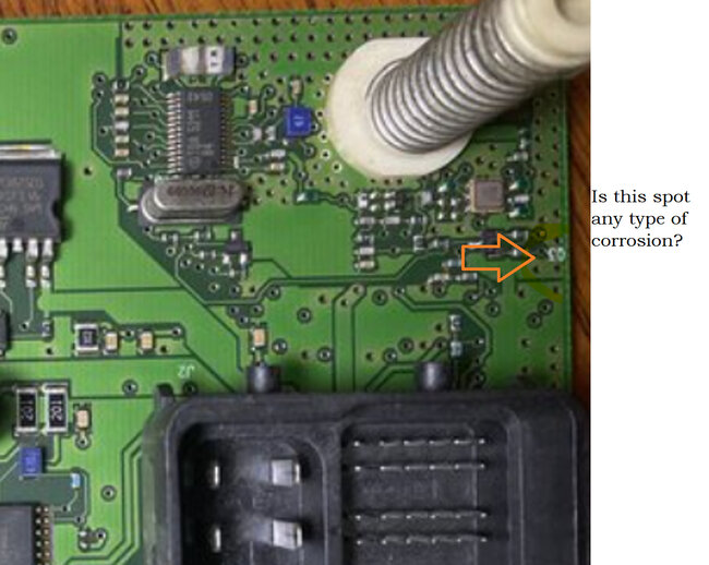

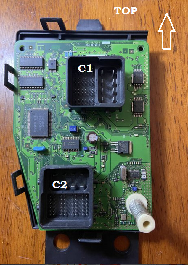

took it to two dealerships they said replace the BCM. Everything works except I can't get the headlights to work during the daytime. refilled the A/C, but it’s blowing hot air, and now the radio is not working. I changed the relay, the ambient light sensor, checked the fuses which were all good. I sent it off to G7 computers and the said it was checksum error but before I sent it off, I noticed a burnt mark on the board. I got it back with the same burnt mark and it seems like the circuit is not connected. I’ve added a photo.

I'm sorry, here’s the photo. thank you in advance.

Hello, yes that is a burn in that circuit, this can happen if there is water intrusion into the BCM's case. Where does the BCM live in your vehicle? The real issue is that a component may have shorted out causing this burned trace on the circuit board.
Also, I don't see any 4-cylinder 2006 Colorado's. Can I get your VIN number to look the vehicle up?
What I do in these situations is use a multimeter and find out which pin on the connector that trace goes to, that way I can identify which circuit it is and what components are on that circuit. You'll want to check the components before replacing the BCM because you don't want a short to fry the new BCM.

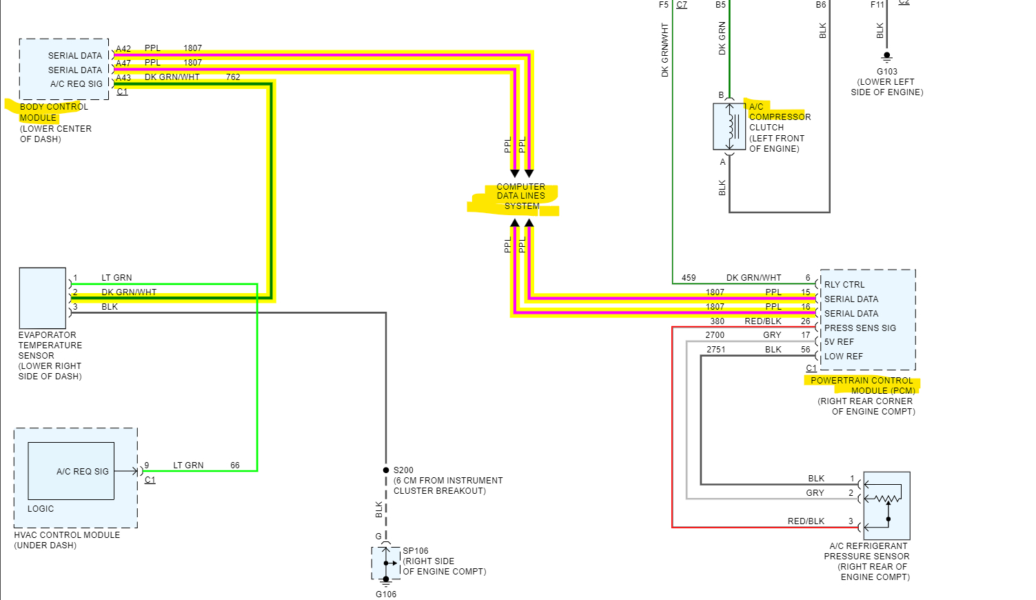

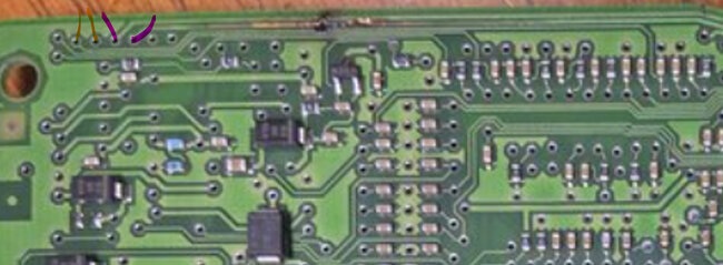

Very wise of you to take a look at the circuit board. It looks like there are possibly 2 or 3 traces that have burned on the board. Looking at it closely. That is an open circuit right now, if you can follow it and see if you can find where it goes, I'm looking at the wiring diagrams and the BCM communication wires are involved with the PCM in turning on the A/C compressor. Will post the diagrams.

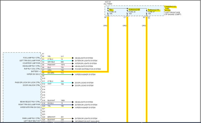

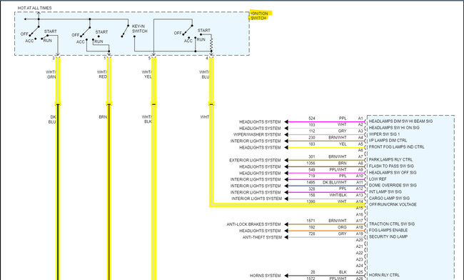

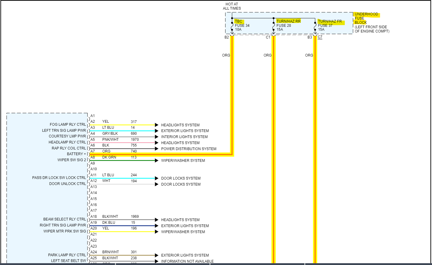

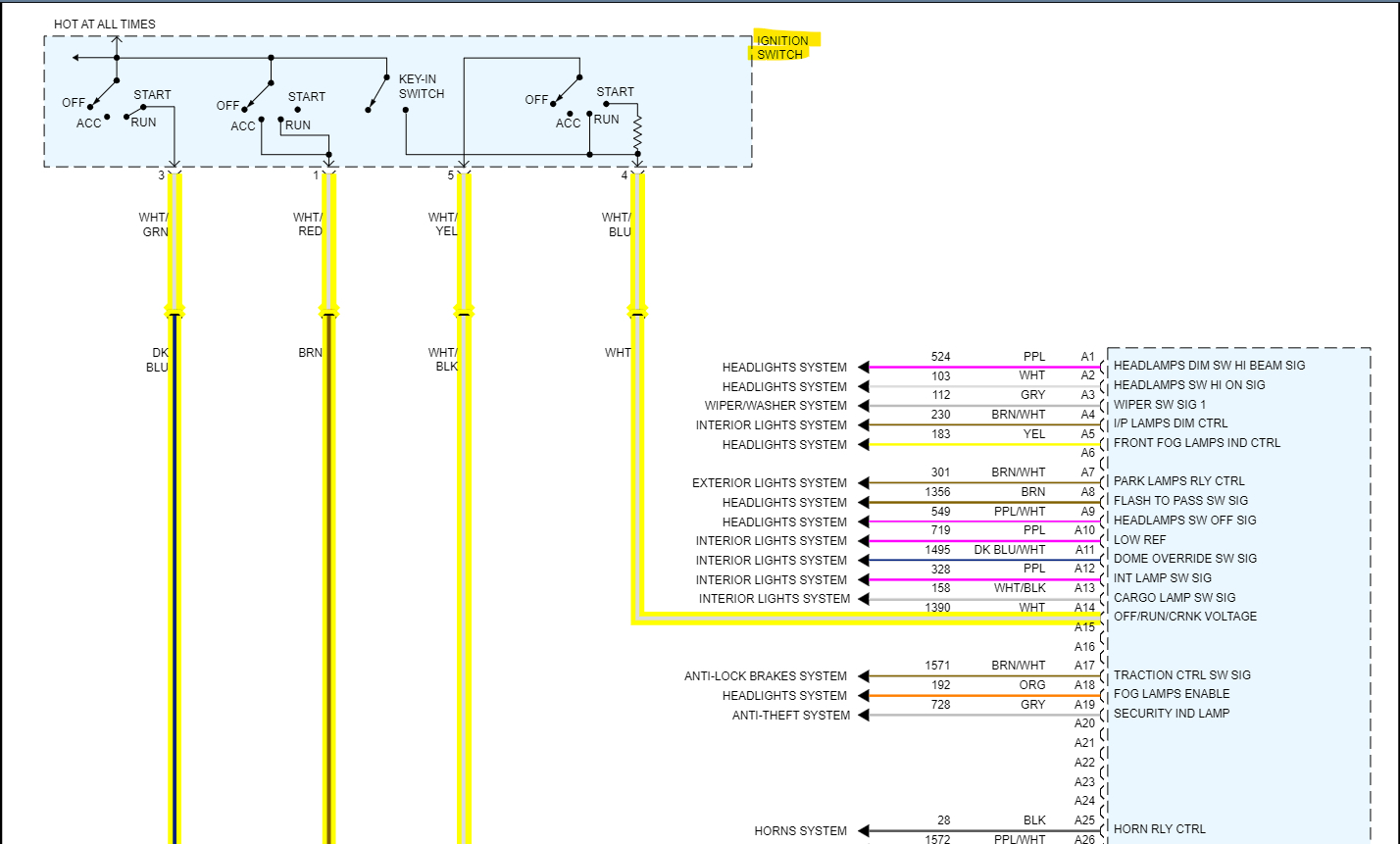

The first two diagrams are the power feeds for the BCM, diagram 1 has the fuses and diagram 2 the ignition switch feeds. And a checksum error means they couldn't communicate with it. There was no saved data they could read, probably because they couldn't power it up possibly. I try to repair these types of components in my spare time. But that circuit shorted out either because of moisture getting into the casing or a component shorted out externally and took out the BCM.

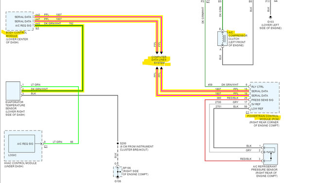

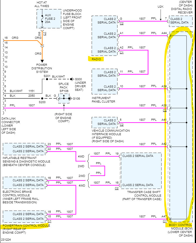

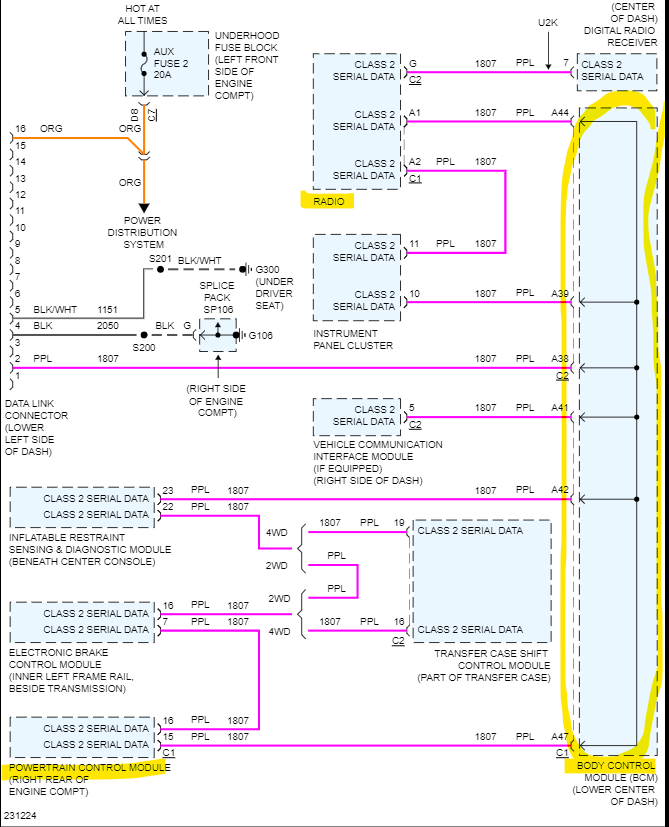

Well, are you looking to get it fixed, obviously the circuit board has a burned trace or two on it, And it looks from a close up picture, to be a short circuit, most of the time when a trace on a circuit board gets corroded from water intrusion or a capacitor leaking its more of a greenish color. That looks like it is burned the circuit. So, for example, on the last engine computer (ECM) I had that failed, it was a shorted-out ignition coil that allowed direct voltage and too much current flow into the ECM and blew apart a mosfet (the driver for the ignition coil). Since your radio and your A/C compressor are not working and they state it was a checksum or data issue, and both the radio and A/C compressor do communicate on a 2 wire serial data network with the BCM being the Gateway module between the modules that control both of those. I'd say that's why they are not functioning. Below is a wiring diagram of the serial bus network and you can see on the right, the BCM is the gateway or link between most modules on that network. So, first thing is to check the fuses for the BCM and see if any of them are blown in the first diagram I posted above. Is this the new BCM that has got the burn mark on it? You were told it needed to be replaced, it got replaced and then the new one burned out too?

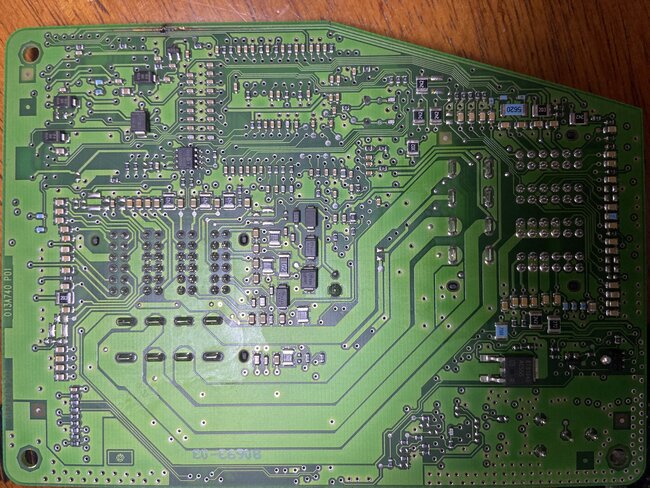

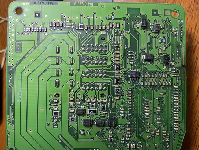

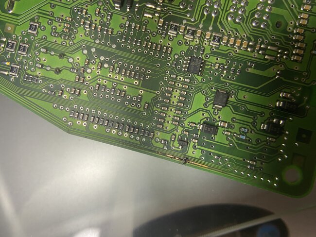

I was going to try and get it fixed, hopefully by you if your time allows- about how much would it cost. The last time I checked all the fuses were good, the relay to the lights were good. Do I need to re-program it after it's fixed? I can check the fuses but it’s raining a lot. Can I get back to you on that one? And I'm sorry Al, I looked over those diagrams and I don't quite understand them yet. I'm sorry, I've included two more photos if that helps.

The last diagram I posted just shows that all the purple wiring runs through the BCM and then out to other modules. So, with the BCM not being in its place there is no communication getting through. I just need you to check the 3 fuses at the top of this diagram, and no, if I can re-solder the trace and fix the circuit on the board it shouldn't need any reprogramming, it should have retained all its original information. The soldering isn't a guarantee fix either, and thanks for the extra pictures, I'm going over them now, I don't see any other damage, but we wouldn't' know until the burn it repaired and I see if I can communicate with it. My only worry is that larger chip in the 1st picture on the bottom left. It appears that is where that circuit runs too. It's most like what controls whatever component is on that circuit. But if you notice any other burn marks let me know. There is a chip shortage right now that has been going on quite a while and a lot of people are waiting for new engine computers and modules, I haven't looked at the price of one of these BCMs, but I'm not sure how that company missed the huge burn on the side of it. My guess is they never bothered to open it up, they just plugged into it and got the checksum error. Hopefully they didn't charge you anything for that.

I appreciate your time. I found used ones on eBay, but I would still have to program it. G7 charged me over $230.00. There’s another company called Module Experts, but I missed his email when I was inquiring for help and he won’t help me, because he’s pissed that I went to G7. As far as getting a new one I went to two dealerships, and they said they don’t make those parts anymore, so they don't want to be liable. It has been pouring where I live so I'm going to need a little time to get under the hood, but I’ll get back to you soon as it clears up, the three fuses are 34, 28 and 37 from the first diagram correct? once again thank you for your time, I appreciate you.

I saw module experts, they cost a lot too. And yeah, a mobile tech would have to come out and program it. I'm not sure what that would cost. The fuses are TBC Fuse 34 (10amp), Turn/Haz RR fuse 28 (15amp), and Turn/Haz FR fuse 37 (15amp). $230.00 for doing nothing, that's not right.

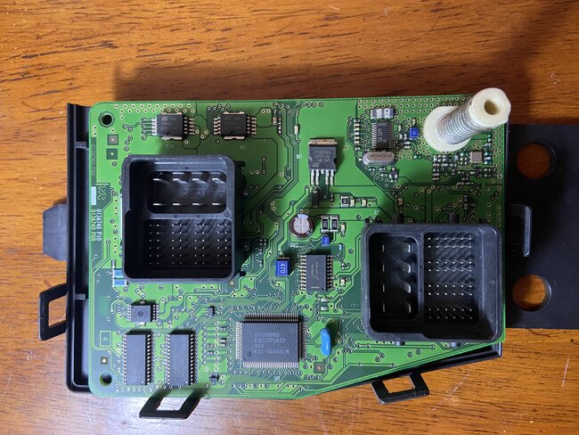

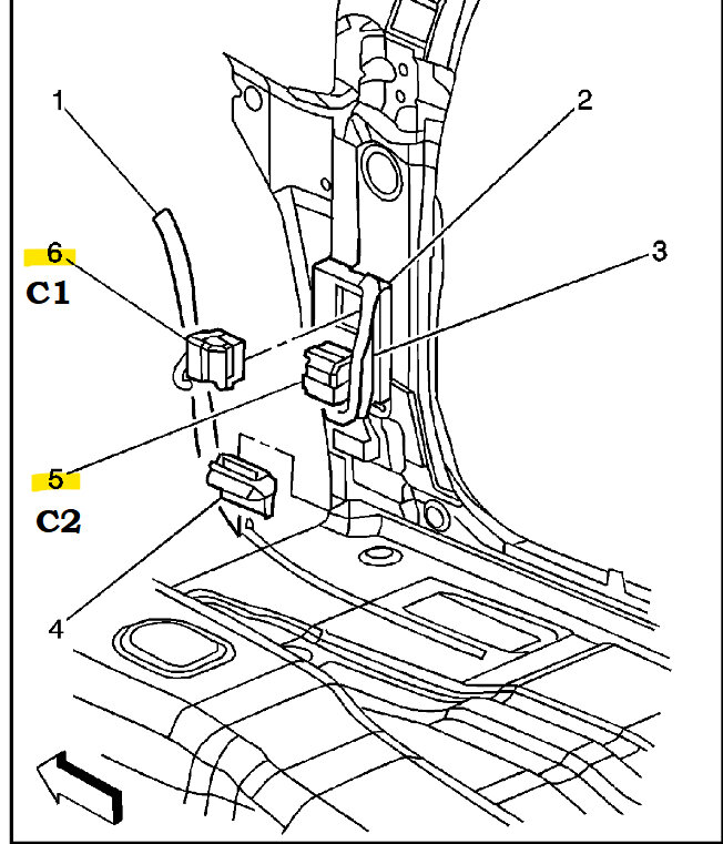

By this picture can you tell me which connector is C1, C1 is the connector that clips sideways. So, the spring-loaded white hold down would be at the bottom, is that correct? I'm just trying to determine which connector the burnt trace goes to. I think the angled section faces down?

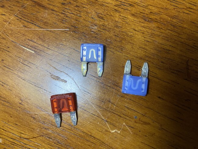

The fuses looked good, I included two photos of the front and back of C1. In the last pic, C1 is the 4 clusters of solders that has 12 solders in a cluster. Other than that, I can't find anything else burnt or broken… Thank you again.

This is correct though, that is the top. I've been going over these pictures some more, it does look like there are a couple or maybe even 4 that ended up getting burned and the traces run down that angled piece and looks like they are from the C2 connector. The C2 also has the Ambient light sensor Ground, Ambient light sensor signal, Accessory Voltage. C1 has the A/C Request signal pin, and although I don't see any pins labelled Radio, the Radio is basically its own module, so it might need some type of wake-up signal from the BCM that it's not receiving and that's why it's not turning on. Everything works on networks now, just like a home internet system. Even if you end up deciding to go with a used BCM, I'd like to give it a try at fixing those circuits. If I can I'll send it back to you and you'll have a backup BCM. I hope some shorted component did cause this though. I always try to figure out what caused a failure like this. especially a burn like that. I wouldn't charge you anything. You paid enough with g7.
