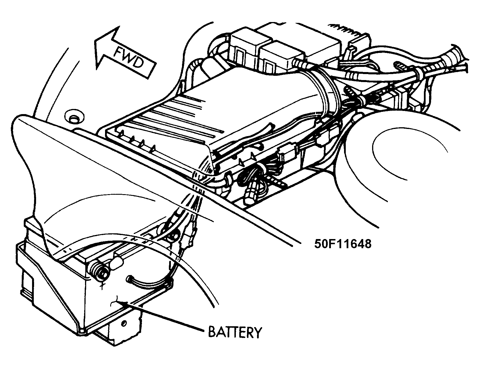

I need to change it, do I take off the wheel to get to it? Also how do I not break nuts and bolts when its cold?

2.4l refer to Pic
