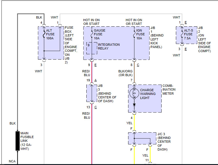

Just replaced the alternator yesterday today my battery light came on. Got it tested at the auto store said battery and alternator is good. So why the light?

Check all fuses in picture use a test light or volt meter. Also, test fusible link that should have twelve volts each side you may have a blown fuse.

Thanks for responding, but I do not know where or what that is.

It is under the hood in under hood fuse box. Each fuse and link has the location of them. Fuse box will say which fuse is which normally on underside of cover.
