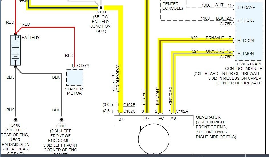

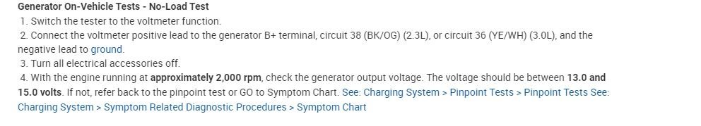

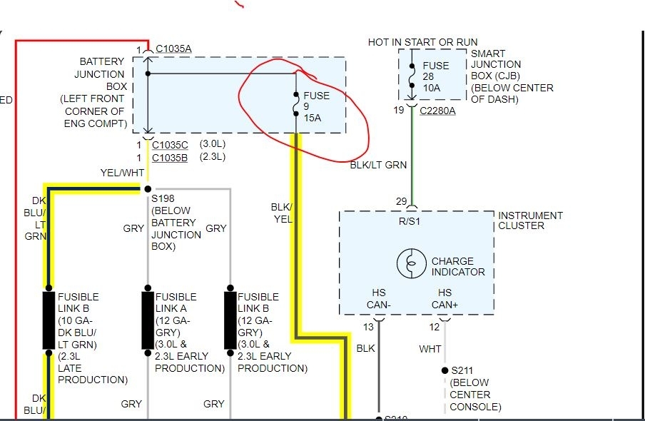

Good morning,
What is the voltage at the battery with the engine running?
The voltage is critical. Also, check for any AC voltage as well. It could still be a bad alternator from a bad diode.
Also, verify the fuse I circled for power on both sides. The ECM controls turning on the alternator depending on the load of the car.

Hey, the voltage when running is 13.4.

It is too low. It should be 14 to 14.5 volts.
