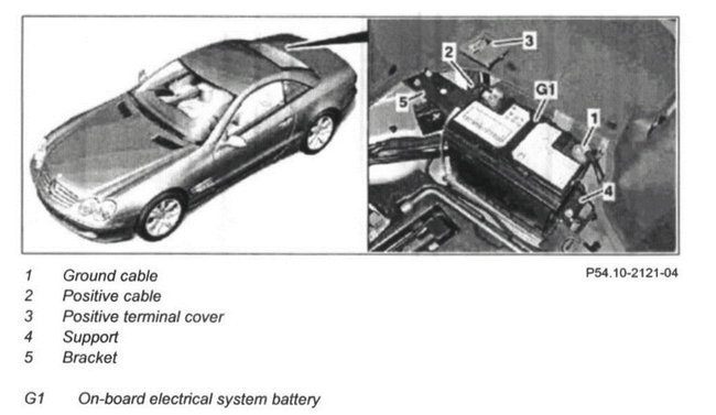

When I bought it went to pick it up and was battery was drained. Jumped it and battery light was on, thought maybe the alternator drained it, but once I drove it home 40 miles away with no issues. Parked it, and same story, not starting. Do these have two batteries? Is the main one under the hood or is there one that is responsible for starting the car only?

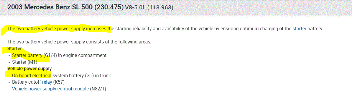

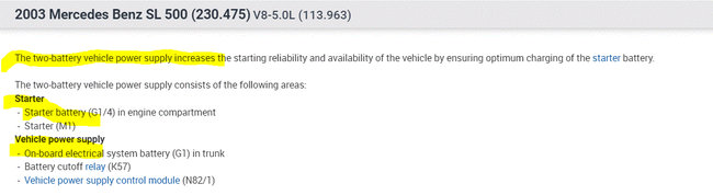

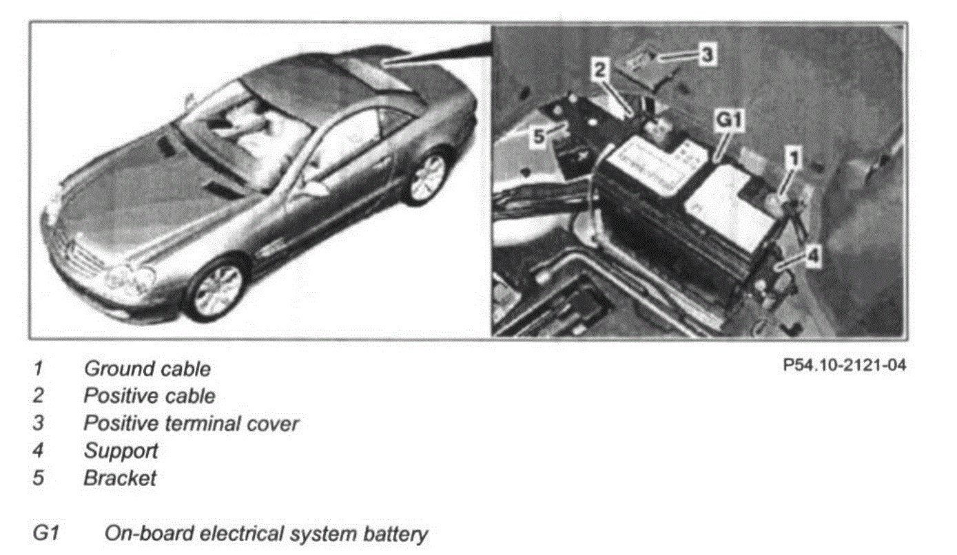

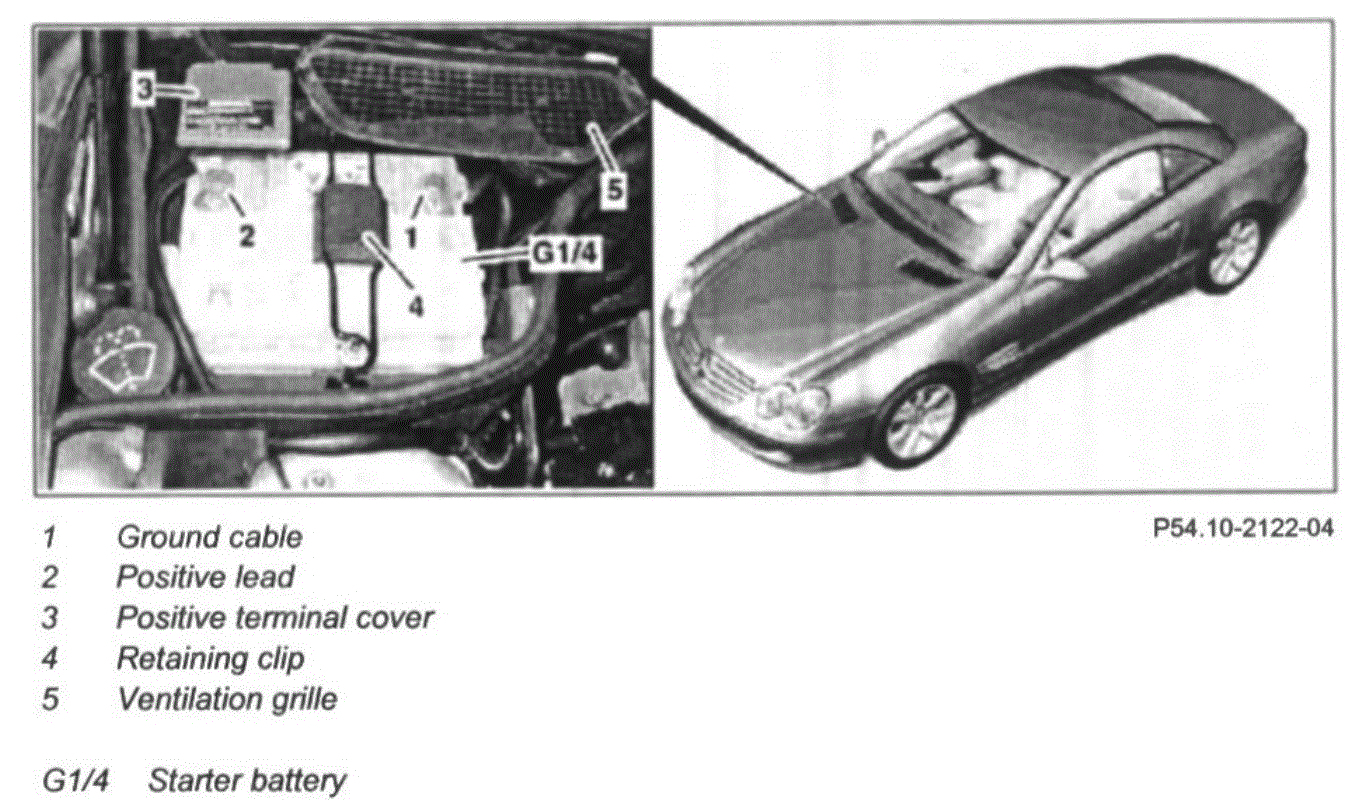

First, I have to apologize. I found there was an option for this model to have a second battery. One is located under the hood and one in the trunk. Read pic 1
If you look at pics 2 and 3, they show the locations of the batteries. The battery for the starter is the one in pic 3, under the hood. The other is for onboard electronics. I suspect that is the one failing.
Again, sorry I made that mistake. Let me know if you have other questions.

Lol, no problem. Yes, I found out earlier today and replaced both, both were weak, starting battery was at 3v. Thank you
