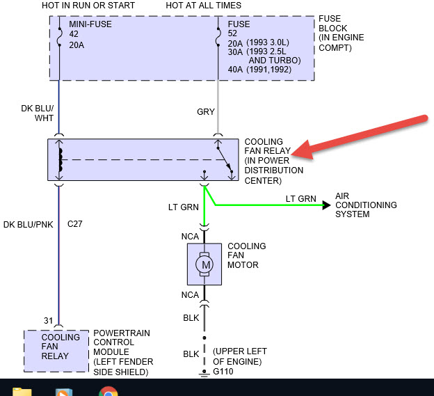

The cooling fan wont stop working on 1993 Chrysler Lebaron. Can the battery be safely disconnected to avoid running it down

Check for a bad cooling fan relay see pic just pull that out instead of battery disconnecct
Image (Click to make bigger)
