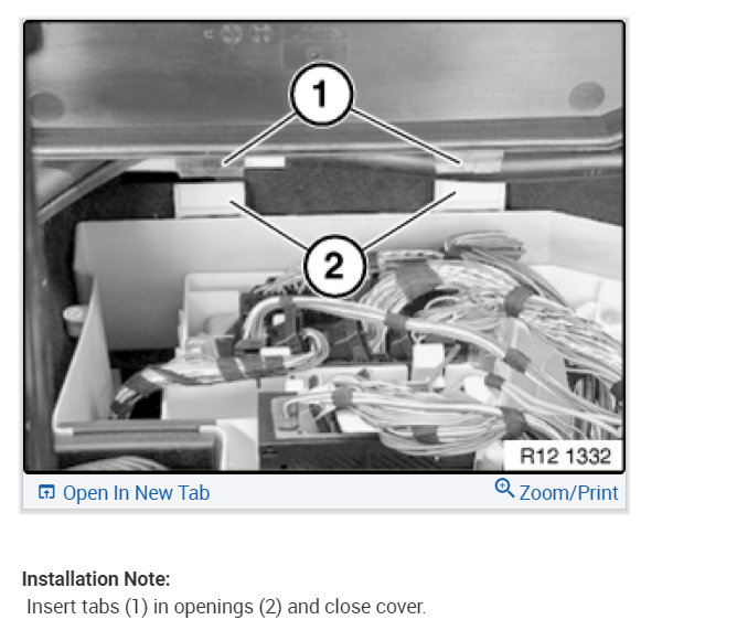

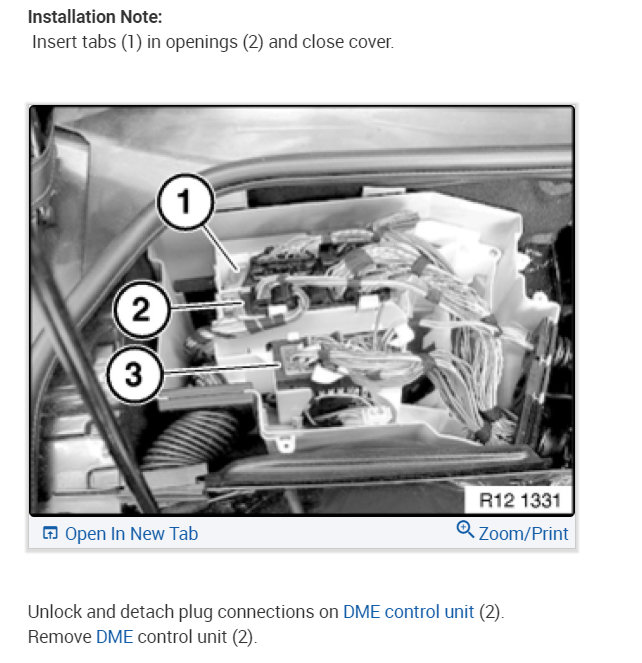

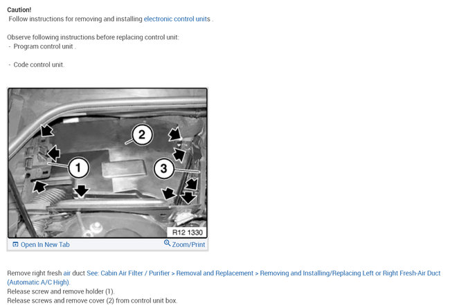

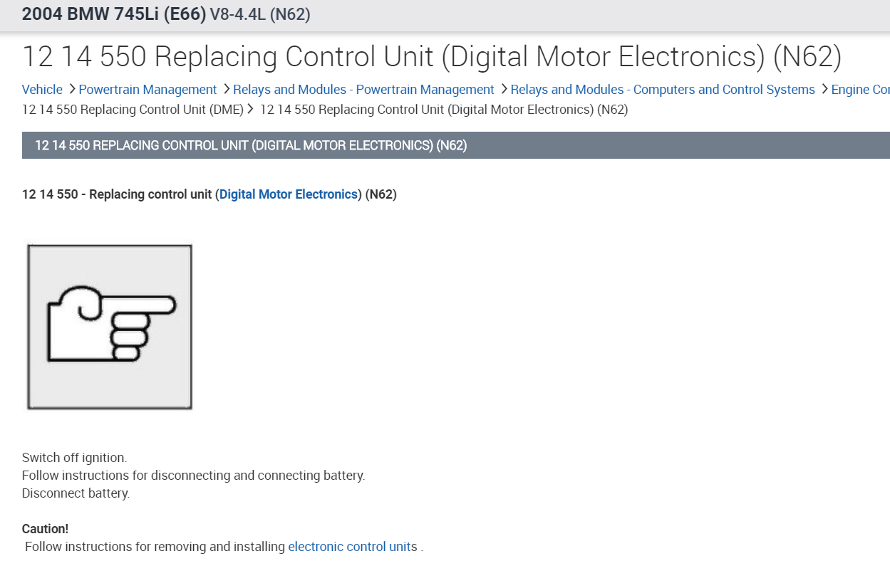

Yep, that can cause the problem here are instructions and diagrams on how to change the ECM out. Check out the diagrams (below). Please let us know what you find. We are interested to see what it is.
+1
Saturday, March 23rd, 2019 AT 2:03 PM
KYLEBMW
  • 5 POSTS
Thank you for your advice. Hmm, I will have to try that. A video on YouTube advised doing that too. I tried yesterday but the screw in the far upper left of the cover was impossible to get to so I gave up until later, We just bought a replacement for the power module in the trunk area too. And a new ECM this morning. Hoping it solves the problem. It is sad seeing the car sitting there.
