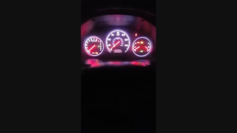

I am going to add a video. The other night the car took longer then usually to start, while I was driving the radio went out and the gauge went black as if the car was off and the car was about to stall. Had the battery tested and it will not hold a charge. I am going to replace the battery. But would the alternator would of ruin the battery? The battery is three years old and I live in Las Vegas
