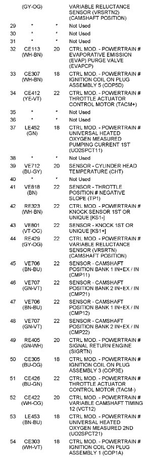

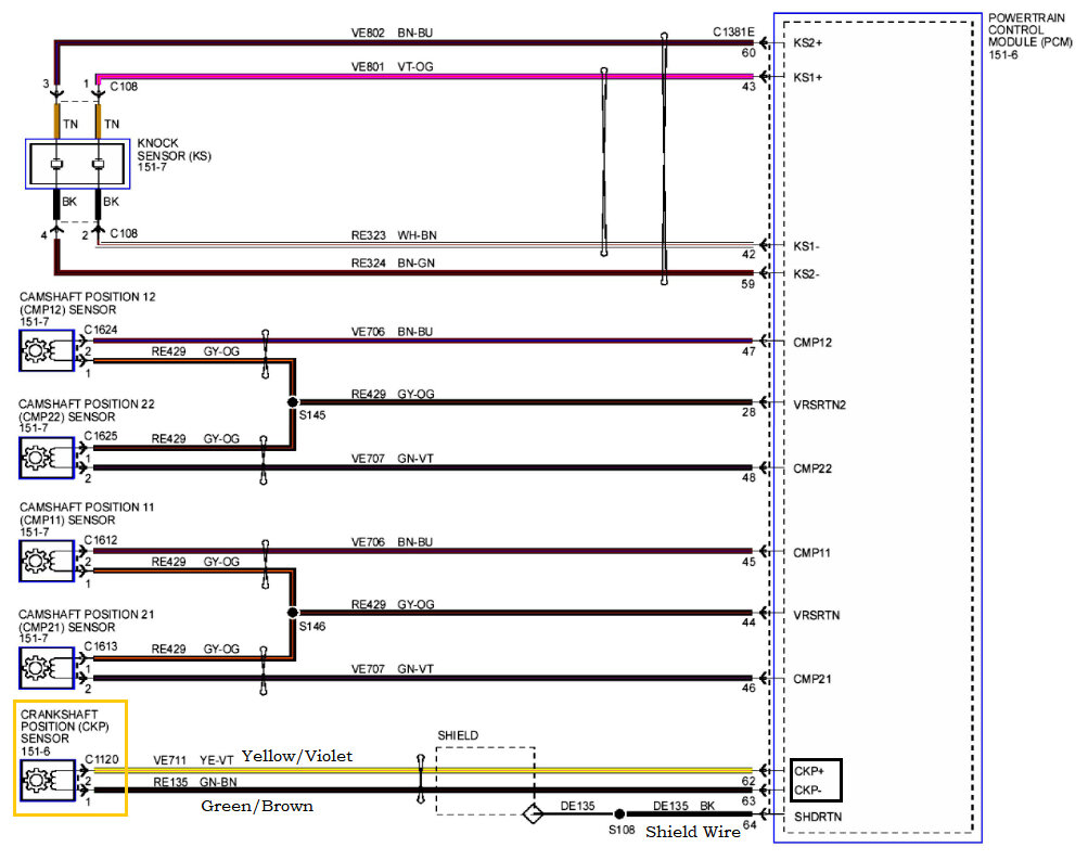

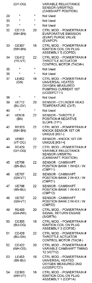

I have a bad wire that runs from the crankshaft position sensor to the computer. Can you tell me what pins on the computer connect to the sensor?

Hello, sure we can get you any diagrams you need, are you dealing with a broken wire?

It's either broken or there's a short. Either way, I need to know which wires I need to look at so I can follow it from the computer to the sensor.

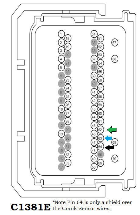

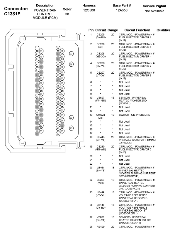

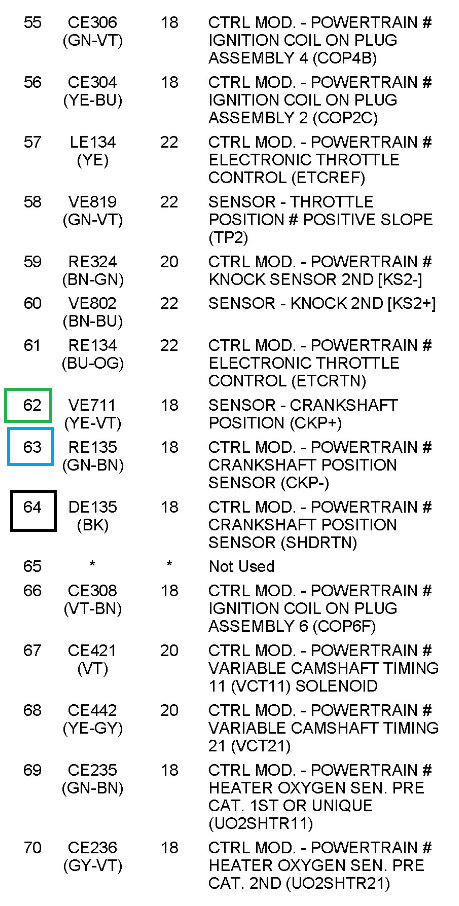

Just be aware there is a black shield wire that runs over the 2 Crank sensor wires to shield them from interference, and they are spliced into the crank sensor wires. The two main crank sensor wires are pins 62-yellow/violet and 63-green/brown.
The 1st diagram is the OEM so it should be correct on coloring.
