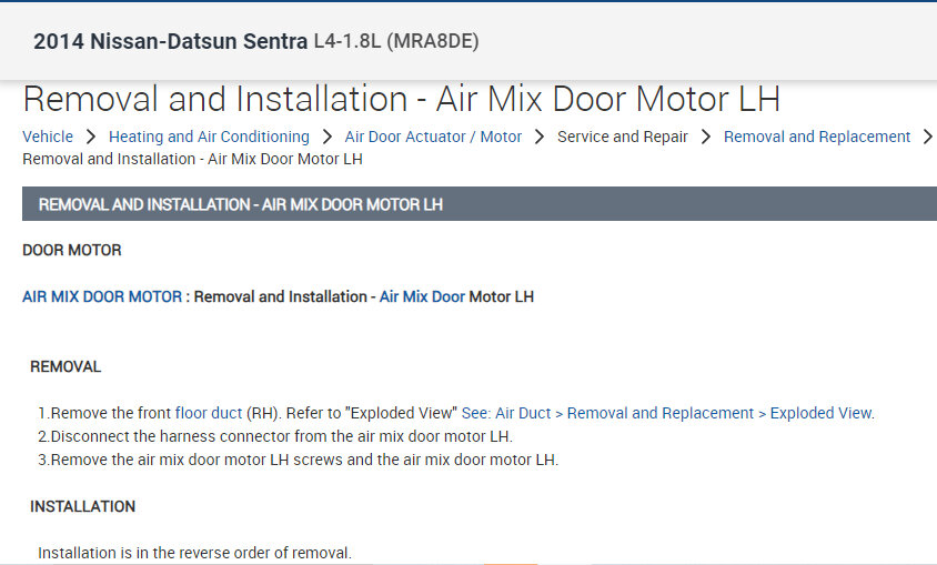

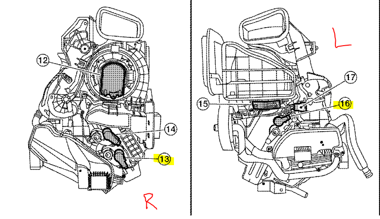

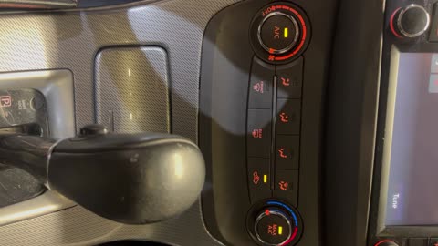

From what I am reading, if you have dual climate control, then the system must also be automatic climate control. So, that is what I used for the directions below.

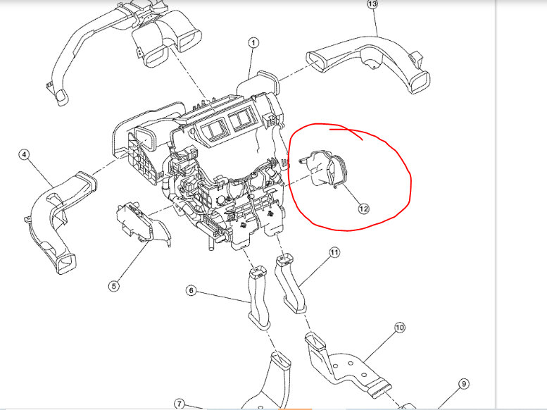

Pic 1 shows the locations. The L and R are left and right sides. Left is the driver's side and the area of concern.
The remaining pictures are the directions for replacing it. Note: Pic 3 shows the section of floor duct that will need removed.

I’m sorry, it is not dual control.

That is interesting. It sounds like the blend door motor is working. If you look at the pics above, you will see where I put L and R on two of them. Remove the one that shows R and see if there is anything preventing the door itself from fully moving.
Since you still have air blowing out from the driver's side, it doesn't sound like the duct work is disconnected.

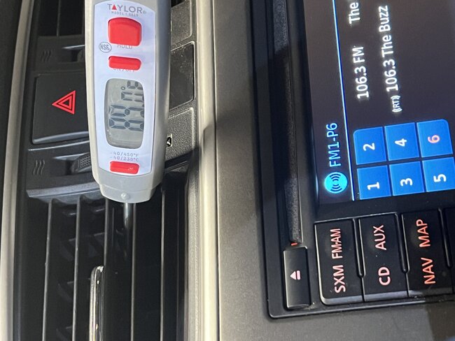

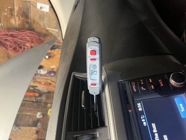

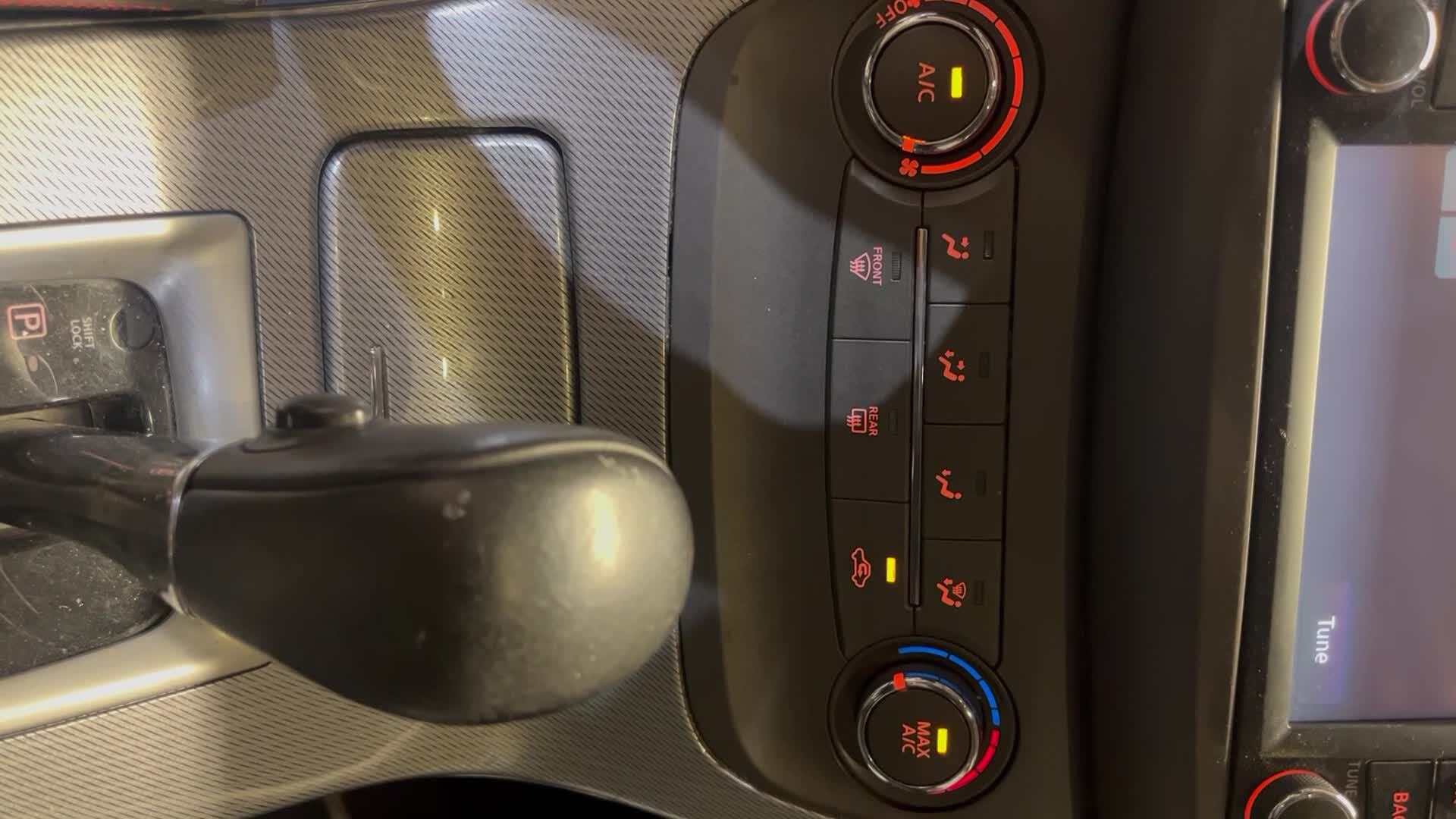

I put a gauge to the low end, it’s in the green. I also put a food thermometer into 1 passenger vent (79F on max A/C) and 1 driver side vent (89F on max A/C) that’s after letting car run for a while too. The A/C compressor kicks on, but there is never any water from the A/C dripping onto the ground. I added a video of the gauge and pics of the temperature of vents. The 1st is the video. The car has new cabin filter and filter under the hood is new too.

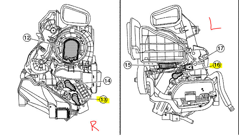

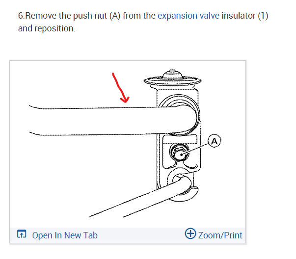

When the A/C system is on for a couple of minutes, grasp the large refrigerant tube coming at the firewall it should be cold. Here is where you should check. Also did you swap out the temperature blend door actuator? Check out the images (below). Let us know how it goes.

Okay, lets check the low side output the as marked above and let me know.

There is the problem, you will need to check the high side pressure of the system to determine if the expansion valve or compressor is bad.

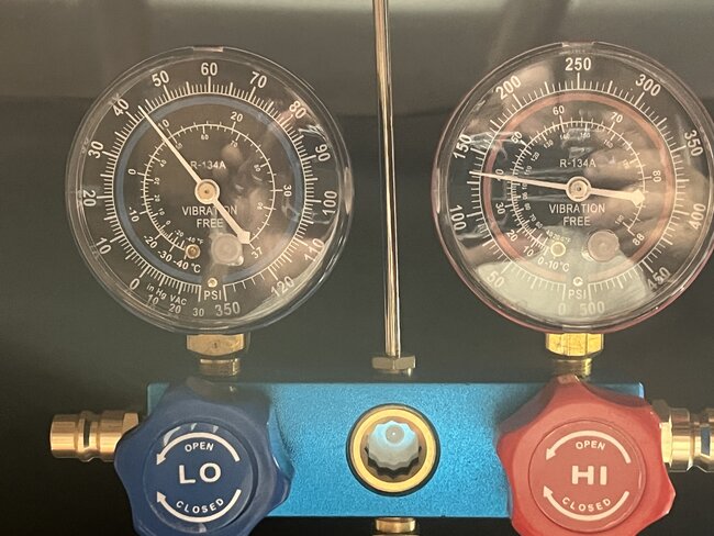

Hooked some gauges up and the low side is in range, but high side is running low. It was around 91f outside.

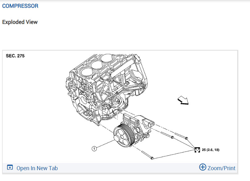

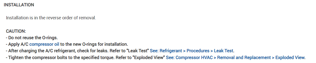

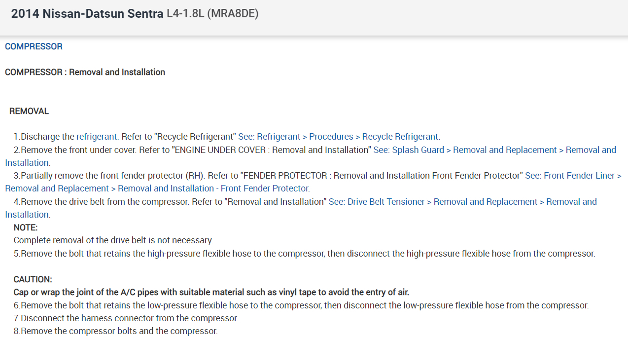

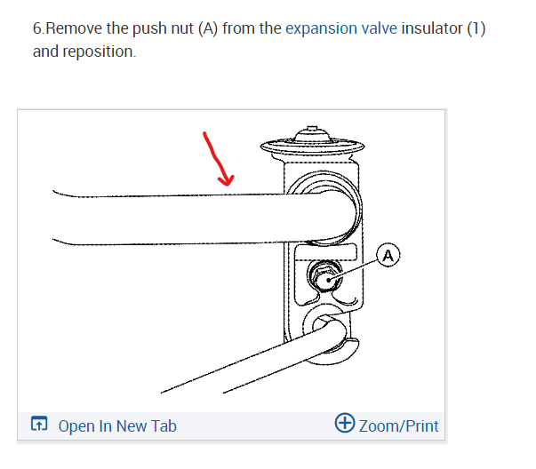

Yep, you have found the problem, either the expansion valve is bad or the compressor, this is why most repair shops replace them both at the same time. You can try the expansion valve first, but I think it is the compressor that is bad. Here is how to change it out. Check out the images (below). Please let us know what happens.

I believe that I’m going to change them both just to play it safe. Thank you for the advice.
