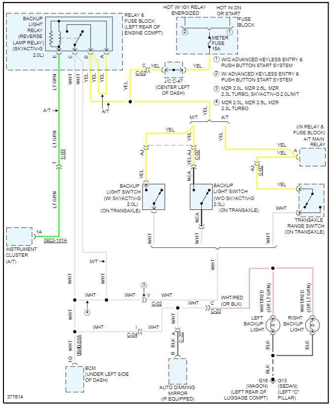

Reverse lights wiring diagram needed?
2012 MAZDA 3
236,000 MILES • 2.0L • 4 CYL • 2WD • MANUAL
JOEPONTIAC
I want to install a backup camera and I want a wire diagram for backup lights.
Thanks.
Aug 23, 2023 at 11:22 PM
  • 54,520 POSTS
Sure, it sounds fun, here is the reverse light wiring diagram so you can complete the job. Check out the images (below). Please let us know what happens.
