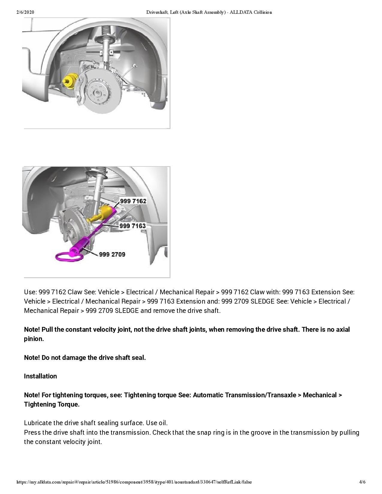

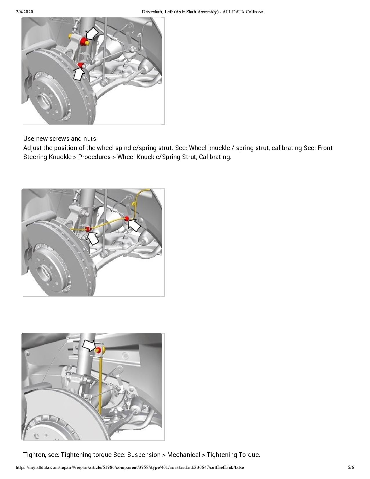

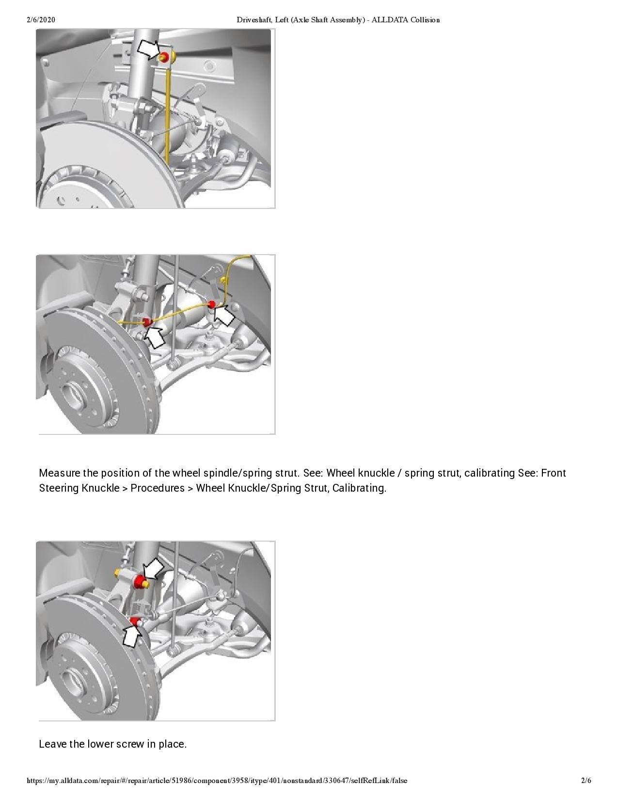

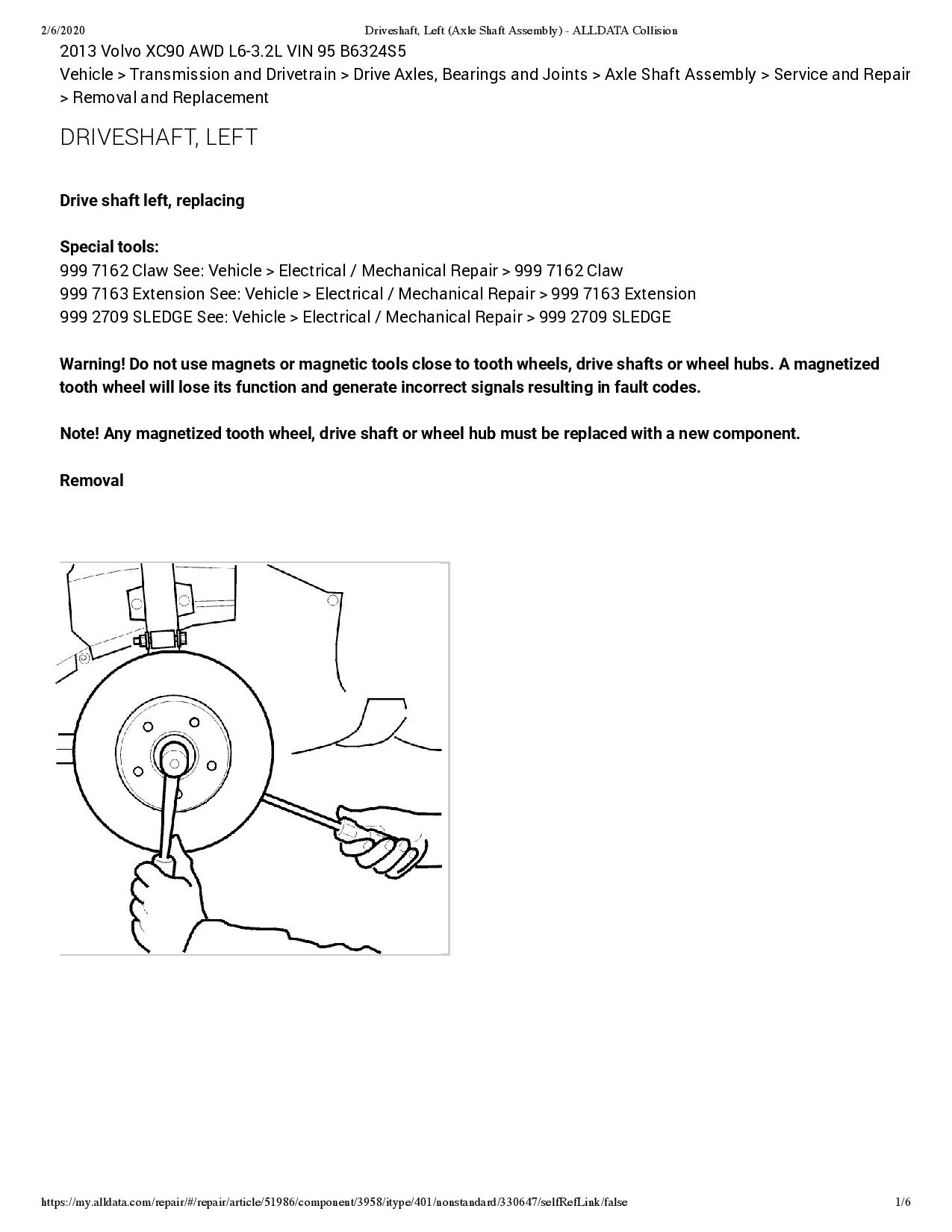

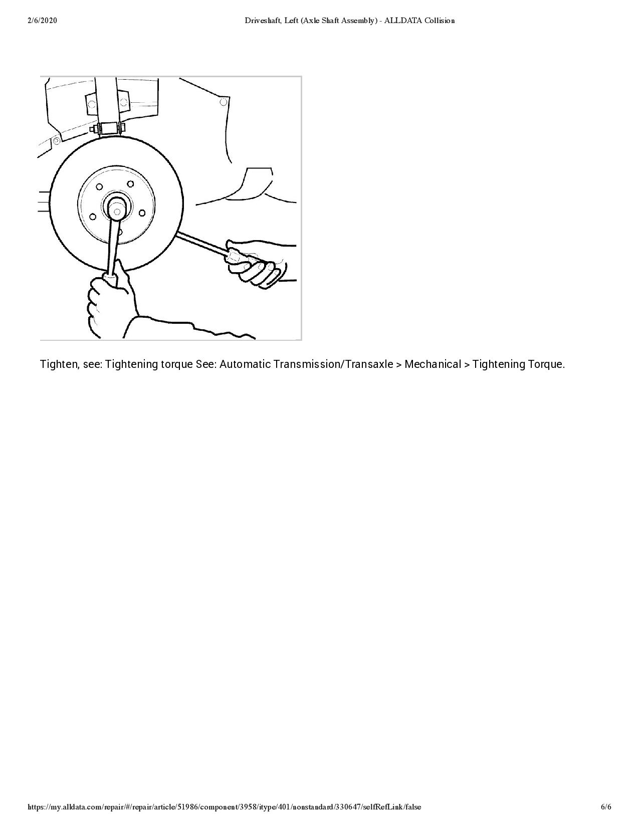

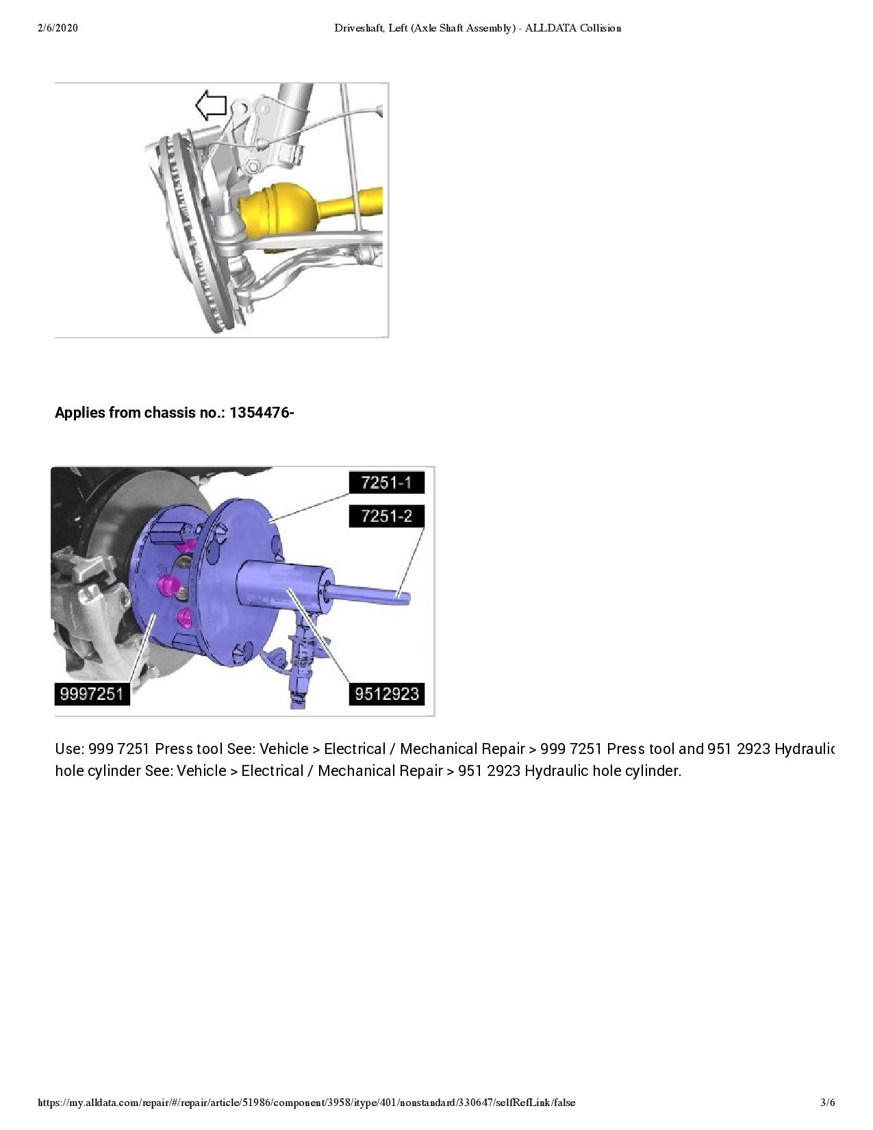

Any instructions on how to replace the driver side axle on this model 3.2l awd?
Feb 6, 2020 at 2:43 PM
JOETECHPRO
  • CAR REPAIR CONTRIBUTOR
  • 705 POSTS
Hey NASER NASER,
Below are the instructions for replacing the left front axle on your Volvo.
Hope this helps, any further questions please don't hesitate to ask.
Regards, Joe

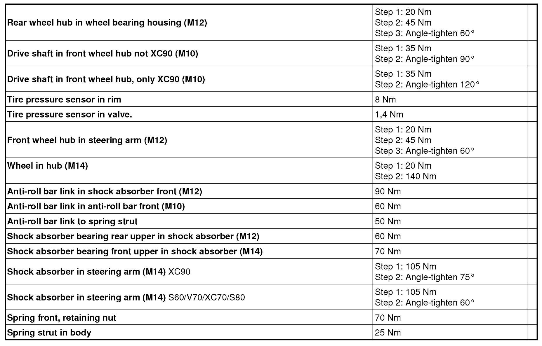

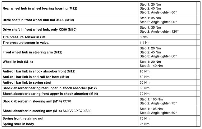

Hi, do you know what the torque is on this axle bolt?
Feb 15, 2020 at 7:53 PM
JOETECHPRO
  • 705 POSTS
Hey NASER NASER,
The spec i have here is for an m10 bolt for XC90 vehicles.
Check the threads on your axle bolt are 10mm in diameter.
It calls for 35NM followed by a further 120 degrees.
You will need a torque angle gauge to torque this correctly or a torque wrench with the angle function.
You should replace the bolt with a new bolt as all angle tightened bolts have to be replaced they cannot be reused.
Regards, Joe
