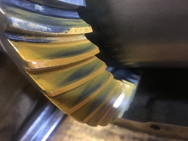

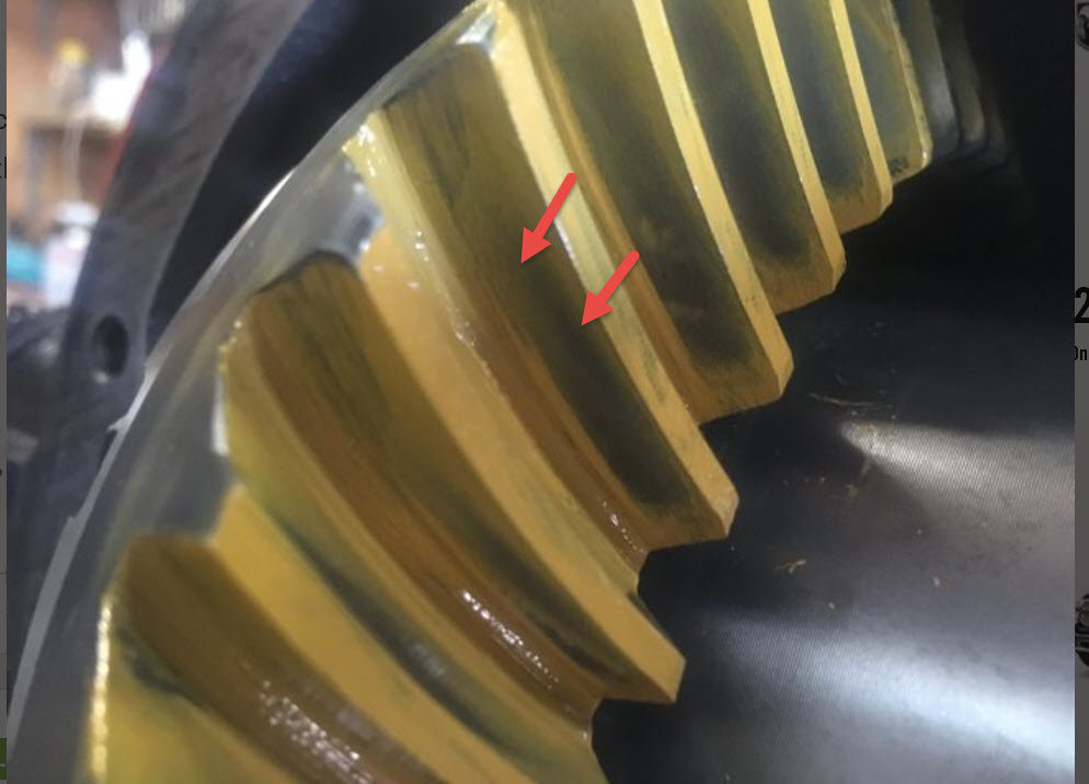

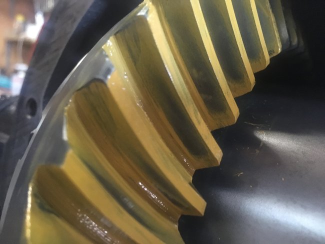

do you think this a acceptable pattern on the old gears? Also my backlash is a .008 right now,or do you think I should shim away for the pinion .003 and recheck?
Sep 6, 2016 at 1:21 PM
HMAC300
  • CAR REPAIR CONTRIBUTOR
  • 48,601 POSTS
where arrows are in pic is where it should be . but the back looks pretty good. if anything you might want to move the pinion in Of course caps should be on and torqued down when you do this so if not then do that and recheck. there are few other things to do when gears are set up which you really can't do at home and or makes it very hard so I'd leave it alone myself. backlash is fine.

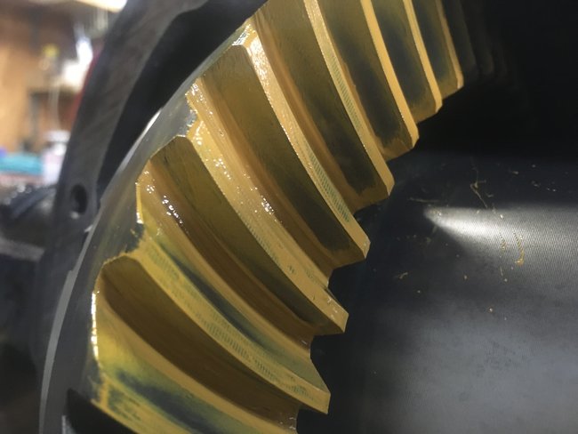

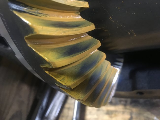

Here it is with .002 added to the pinion, backlash went to .006. This one or other? I kinda think the other one but what do you think?
Sep 6, 2016 at 4:06 PM
HMAC300
  • 48,601 POSTS
leave it alone it's good enough

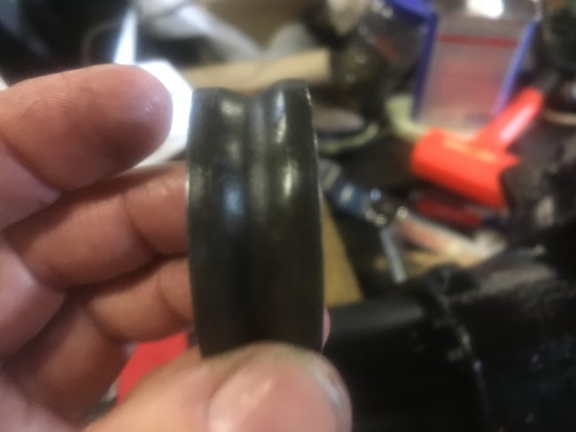

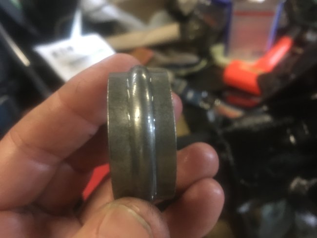

when I did the initial set up for the pinion and carrier I used sacrificial bearings for the pinion honed out ever so slightly so they would slide on the pinion with a little resistance. I pressed carrier bearings on and established pinion depth,backlash and gear pattern with the help from y'all and got an exactable gear pattern and backlash. Note all this set up was done of course with no crush sleeve. Now I press the new pinion bearing on the shaft with the shims and go to install in case, tightened the nut on yoke until it bottomed out on the crush sleeve and there is play in and out on the pinion in the case. could it be a wrong crush sleeve, maybe? or something else?
Sep 8, 2016 at 1:04 PM
JASONPYZO
  • 87 POSTS
old crush sleeve widths.588 and new one is .627?
Sep 8, 2016 at 1:14 PM
JASONPYZO
  • 87 POSTS
heres the new crush sleeve on the left and the old on the right, they look different on how they will crush. can that be a problem?
Sep 8, 2016 at 2:58 PM
HMAC300
  • 48,601 POSTS
looks like the wrong crush sleeve it may be for a 8.5 or 8 & 3/4 axle been a while . the new one should look like the old one and should slide on pinion if new one doesn't slide on pinion gear and is wiggling on it it's wrong.
Sep 8, 2016 at 3:18 PM
HMAC300
  • 48,601 POSTS

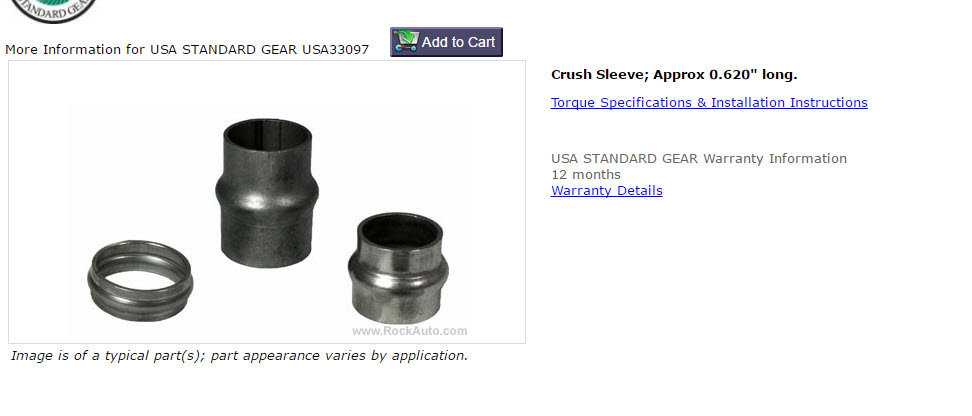

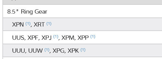

to verify it is an 8.5 axle it should have one of the series stampedon front rh tube it lookslike the wrong crush sleeve though. the ones shon in pic are for a8.5 30 spline what you have looks like for SOME 8.5 and 8.75 ring gears.
Sep 8, 2016 at 3:26 PM
JASONPYZO
  • 87 POSTS
ok thanks
HMAC300
  • 48,601 POSTS
these were at rock auto btw
Sep 8, 2016 at 4:24 PM
JASONPYZO
  • 87 POSTS
The axle is 8.5 and 30 spline pre vin # by the dealer. Truck was bought brand new by my folks and handed down. Also I pick up a set of crush sleeves from Napa for 8.5 & 8.75 rings and the smaller one is still to big, going by what you say and that you are not supposed to have any play when you slide the crush sleeve over the pinion shaft and if thats so its still wrong. I seen the ones from Rock Auto and looks like the same one I got, going to try dealer tomorrow and see what happens or if you have another idea.
Sep 8, 2016 at 7:59 PM
HMAC300
  • 48,601 POSTS
the one you sent to me via picture is the wrong one you should have one that is similar in appearance to the pics I sent the one on the left looks to be the correct one in the pics I sent. At rock auto it even said 30 spline.
