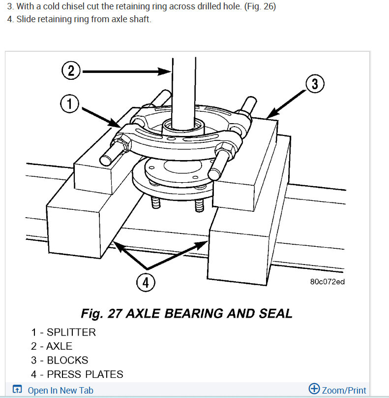

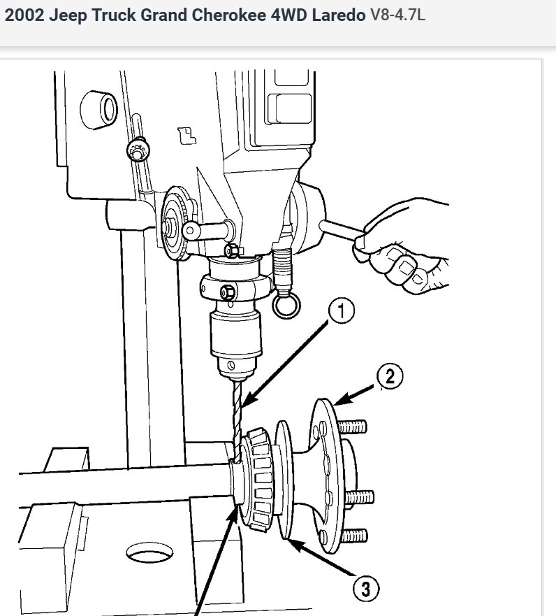

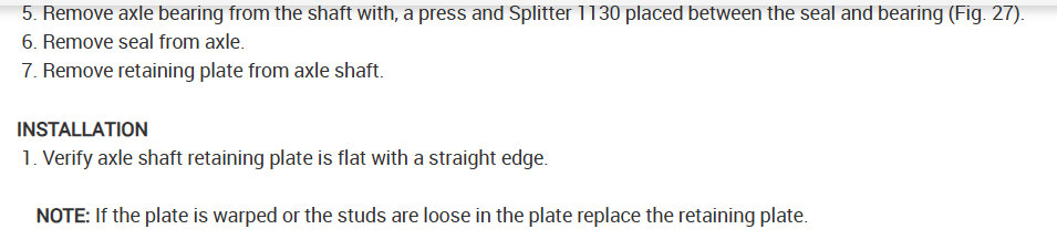

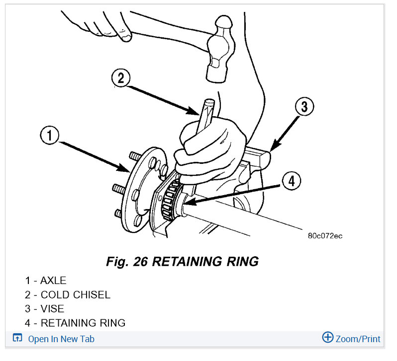

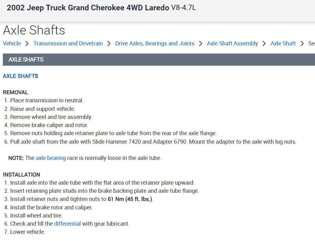

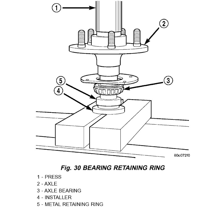

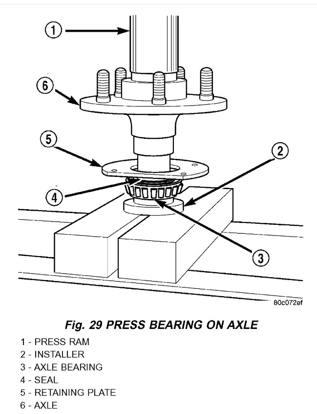

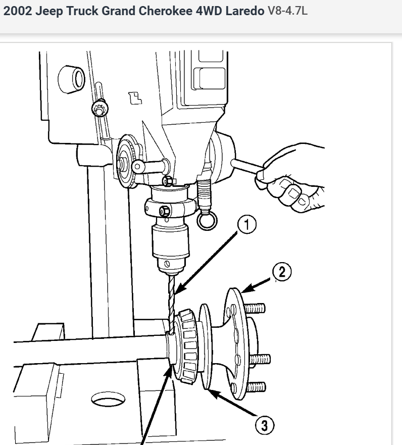

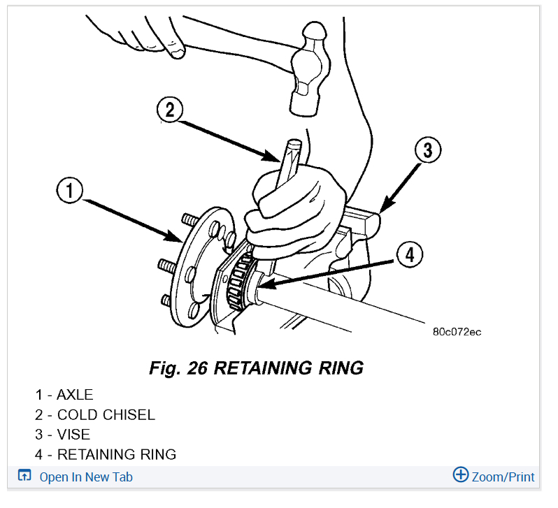

I assume it is the rear axle seal. If so, here is how to change it out and the gear oil needed to complete the repair. FYI you may have an axle bearing that is going out which causes the seal to leak. This video can help because you will need to use a press or have a machine shop do the press work for you. You will need a new seal and axle bearing to complete the job.
https://www.youtube.com/watch?v=_FzmmBoa4Tg&t
Fluid Types
Front Axle
186 FBI (Model 30) .................... Mopar Synthetic Gear Lubricant 75W-140
Rear Axle
194 RBI (Model 35) .................... Mopar Gear Lubricant 80W-90 (Trailer Towing - Mopar Synthetic Gear Lubricant 75W-140)
226 RBI (Model 44) .................... Mopar Gear Lubricant 80W-90 (Trailer Towing - Mopar Synthetic Gear Lubricant 75W-140)
Note: Trac-Lok and Vari-Lok equipped axles require Limited Slip Additive be added to the lubricant.
Capacities
FLUID CAPACITY
Front Axle - 186 FBI (Model 30) * .................... 1.18Liters (2.5 pts.)
Rear Axle - 198RBI (Model 35) * .................... 1.66Liters (3.5 pts.)
Rear Axle - 226 RBA (Model 44) ** .................... 2.24Liters (4.75 pts.)
* With Vari-Lok, add 0.07Liters (2.5 oz.) of Friction Modifier.
** With Trac-lok or Vari-Lok, add 0.07Liters (2.5 oz.) of Friction Modifier.
Check out the images (below). Let us know if you need anything else.
