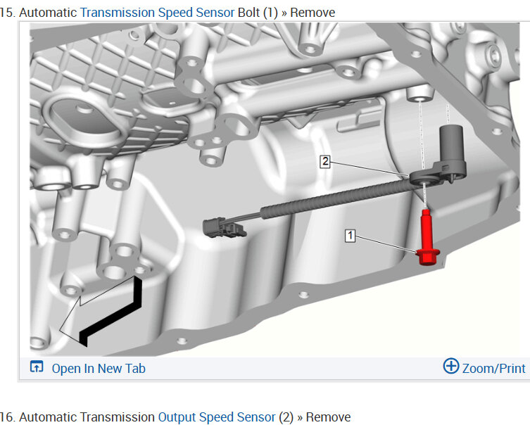

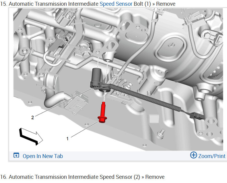

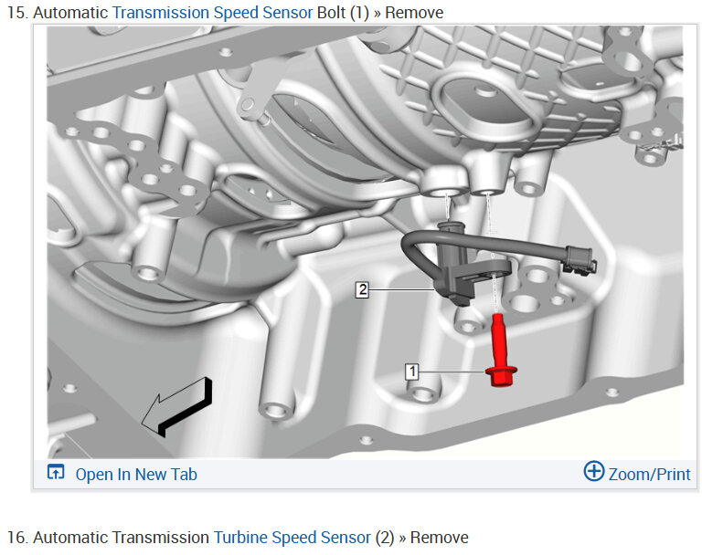

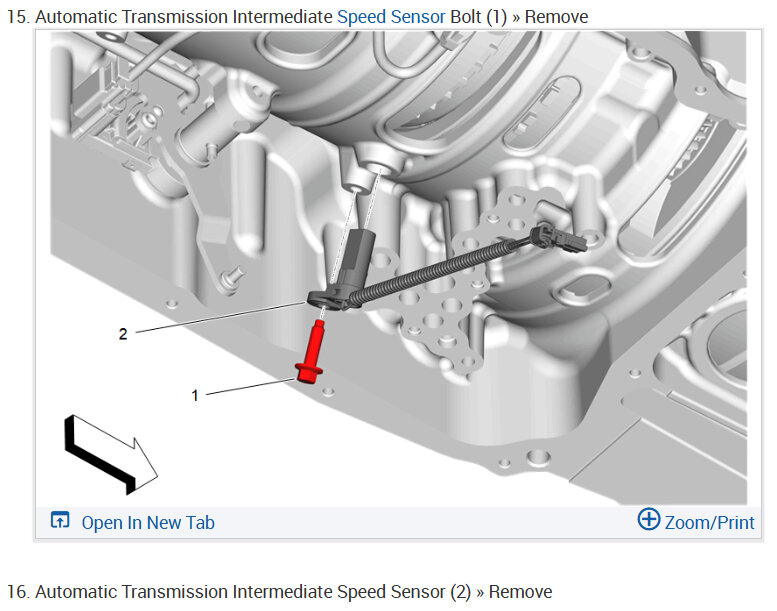

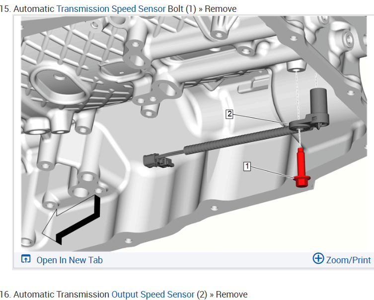

Automatic transmission speed sensors?
122,000 MILES • 5.3L • V8 • 4WD • AUTOMATIC
DAVID HAMM
Needing to know (or make sure) the correct location and part number.
Jun 17, 2025 at 9:51 AM
  • 55,746 POSTS
10 speed transmission? If so, this unit has an output shaft, input shaft and two intermediate shaft speed sensors which all require the valve body to be removed. Here are the location of the sensors so you can check it out. Check out the images (below). Let us know how it goes.
