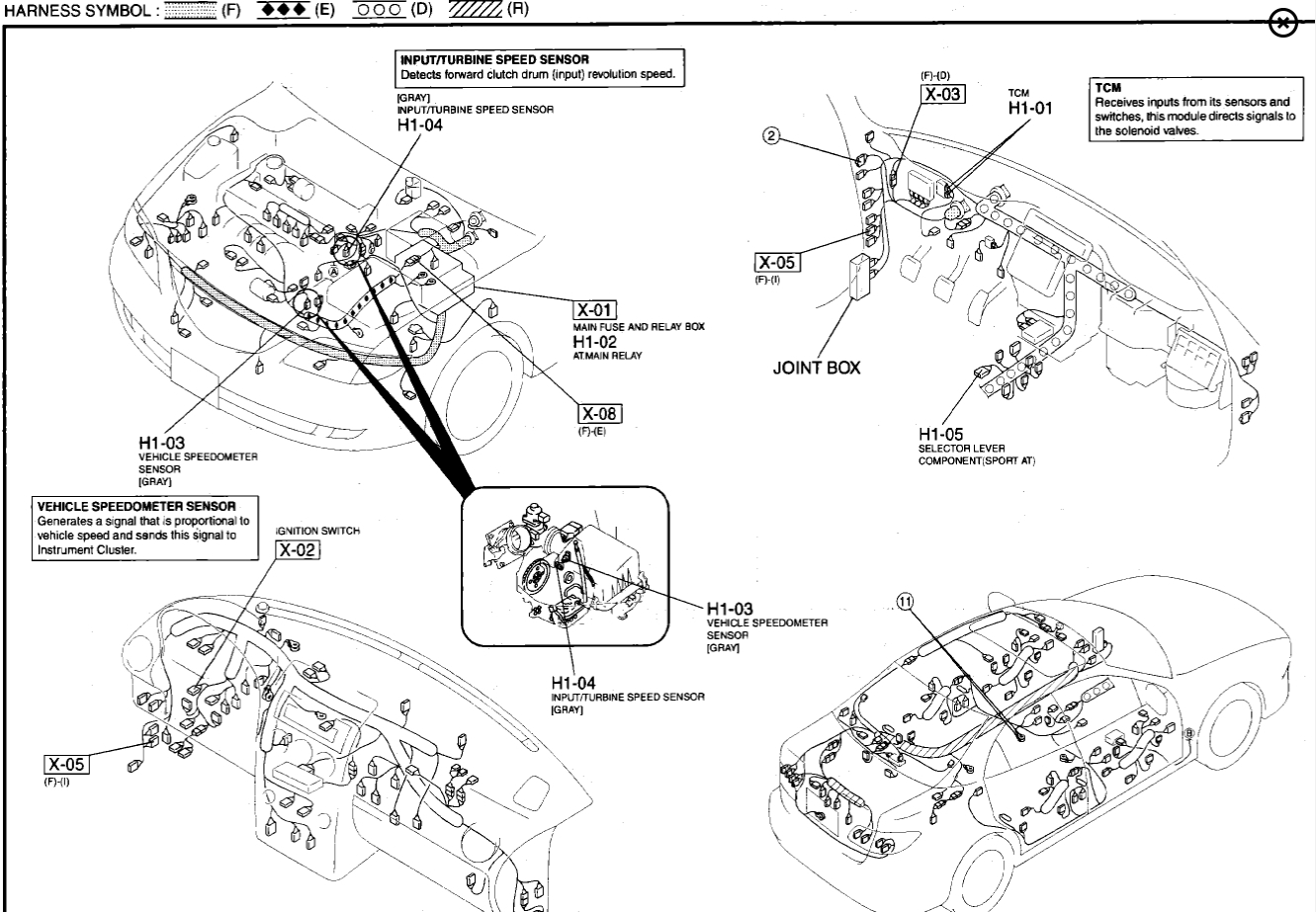

It sounds like you have a turbine speeds sensor that is out in the transmission which will not cause a check engine light.
Here is the location of the sensor.
Please run this test and get back to us.

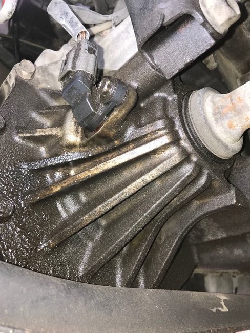

The image is not so clear for me, but do you mean the "vehicle/transmission speed sensor"? (See my pictures)
Is the "vehicle/transmission speed sensor" the same as the turbine speeds sensor and the vehicle speedometer sensor H1-03?
Is the "input/turbine speed sensor" H1-04 another sensor?
Saturday, April 21st, 2018 AT 5:53 AM
KEN L
  • MASTER CERTIFIED MECHANIC
  • 55,488 POSTS
There are two sensors the one in the photo is the output shaft speed sensor or the VSS. Does the speedometer work okay? If so replace the input or turbine speed sensor. I do not know why I said run this test. Lol

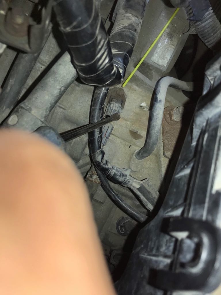

NELMAR
  • 15 POSTS
Hello Ken,
Thanks for the reply.
Yes, the speedometer is working fine.
I did a test by pulling the plug out and it stops working and remain back when push the plug back in its place.
Would you please show me where the second sensor is located?
And what is the name of this sensor?
Waiting for your reply.
Thanks again.
You are awesome my friend.
Thumbs up.
Nel.
Saturday, April 21st, 2018 AT 12:51 PM

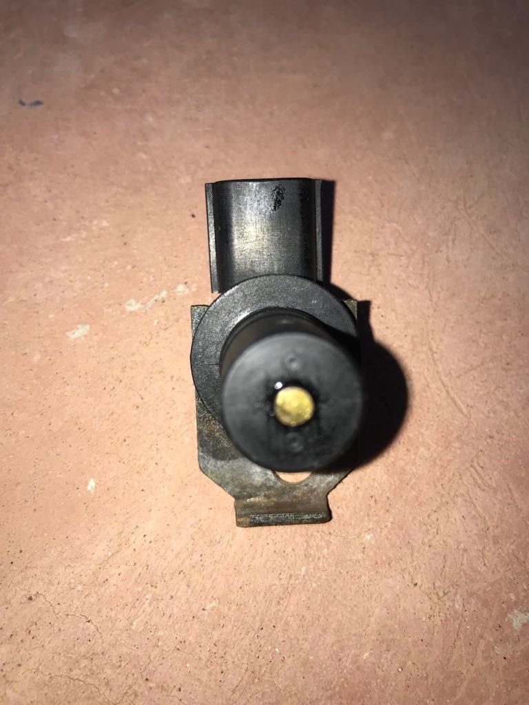

NELMAR
  • 15 POSTS
Dear Ken,

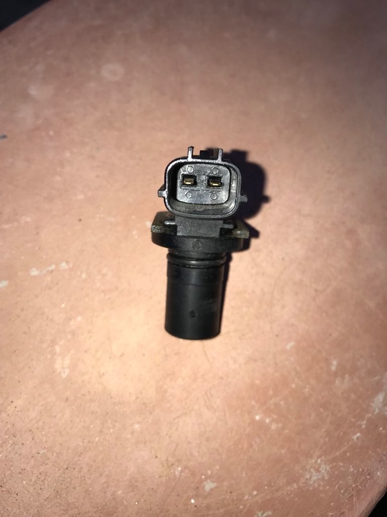

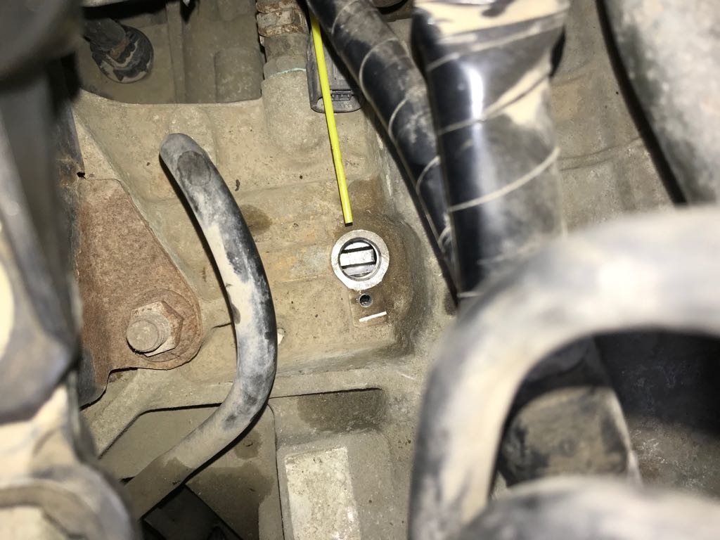

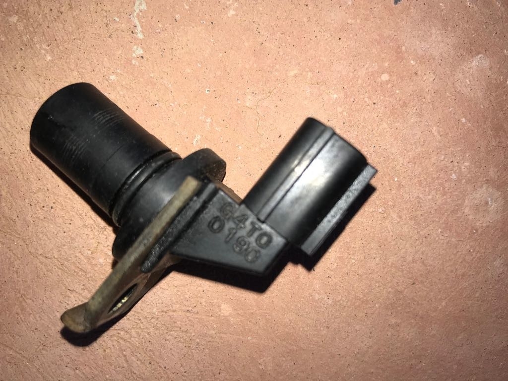

I think I got it. (See my pictures)
G4TO-0190 is the number on the sensor.
1st pic is the sensor unpluged (see yellow sign)
2nd pic is the mounthing hole without the sensor.
Saturday, April 21st, 2018 AT 8:15 PM

I would like to say its the first image, I noticed you put 2003 Mazda 323 is this right? I do not show a 323 in 2003?

NELMAR
  • 15 POSTS
Hi Ken,
Nice to have you back.
Both images are the same place.
As I indicate before; first picture is the sensor unplugged (see yellow sign).
Second picture is the mounting hole without the sensor. Hole without the sensor. Hole without the sensor.

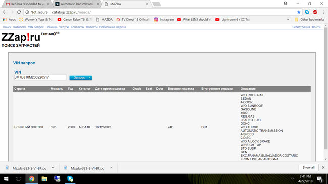

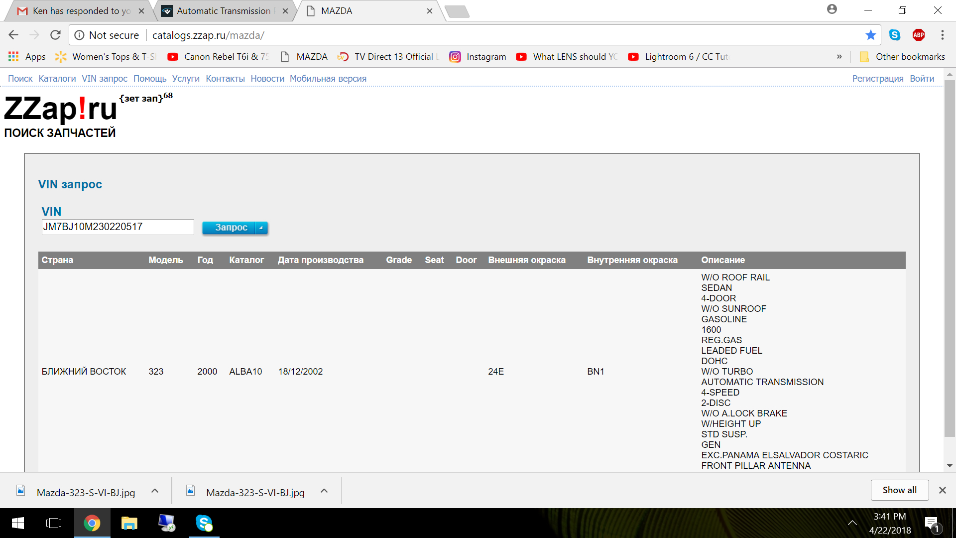

Car information:
Vin # JM7BJ10M230220517
Mazda 323 F, GLX
Made in Japan
Year 2003
Gasolin
Motor: ZL1
4 cilinder, 1.8 Ltr
Automatic Transmission
Note: Please visit Zzap. Ru and type the VIN #.
Select # 13 - 1920
Do you think that one of these sensors are giving this problem.
The Speed Sensor is doing well otherwise I do not get the speed-o-meter working.
The second sensor is called "Generator pulse sensor".
Maiby this is the problem.
Do you know how to test it?

KEN L
  • 55,488 POSTS
Okay great, a pulse generator is the same as a speed sensor so if the speedometer is working okay that is the sensor I would replace.
Clear the codes after you install it and let me know how it goes.

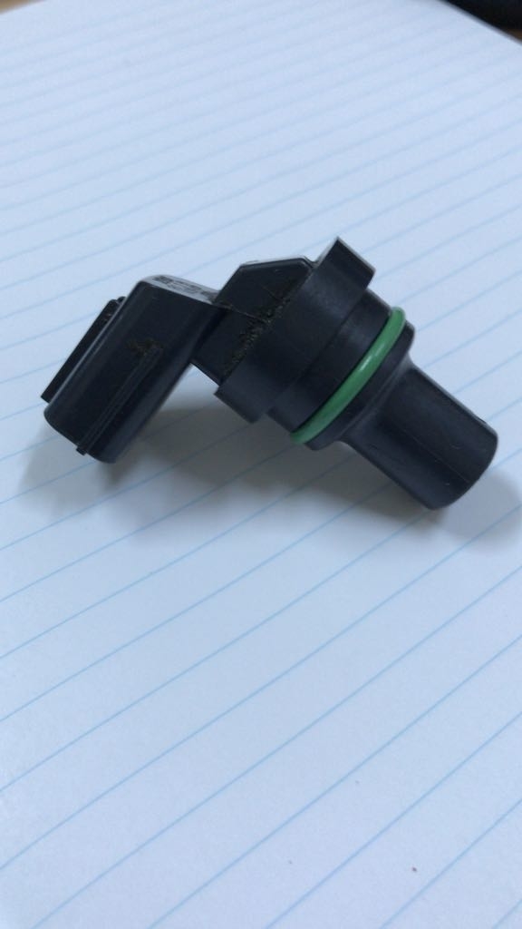

NELMAR
  • 15 POSTS
Okay, Ken.
This morning I have put an order for a new generator pulse sensor.
Part # FN01 21-550.
Arrival date will be next week in the weekend.
Will let you know as soon I have it.
Once again many many thanks.
Have a great day.
Regards
Nel.

NELMAR
  • 15 POSTS
Dear Ken,
First of all I think there was a malfunction/error with this site.
I will repeat my previous reply.
Thank you very very much for a professional assistance in order to have my car fixed.
After a long time of waiting for my order and a short vacation in between I got the Pulse Generator Sensor installed.
I can tell you that I am very sad and disappointed after the test-drive.
There is absolutely no change at all in the way the car is changing gears after installed the new Pulse Generator Sensor.
Still delaying to go over to the next gear.
As you now I did a lot trouble shooting, renewing sensors and other parts.
But I still appreciating your professional assistance and still positive that together as a team we can fix it.
Hope to have informed you accordingly.
Waiting for your soonest reply.
Many many thanks Ken.
Regards and have a nice day.
Nel.
