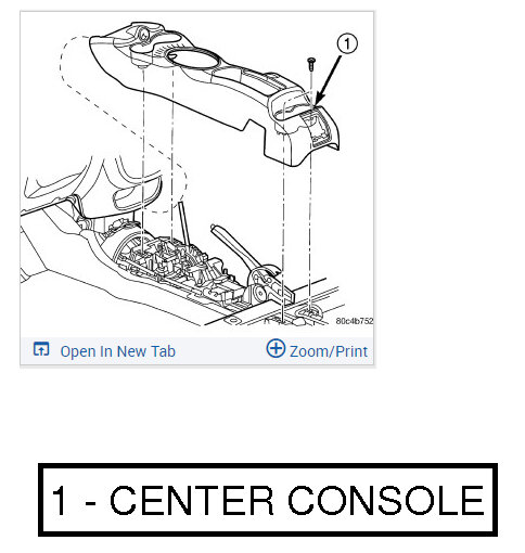

Chances are the shifter itself isn't the problem, but it could be.

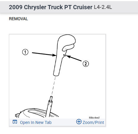

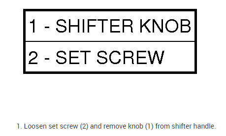

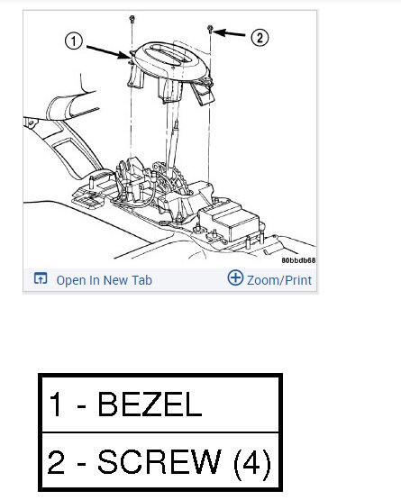

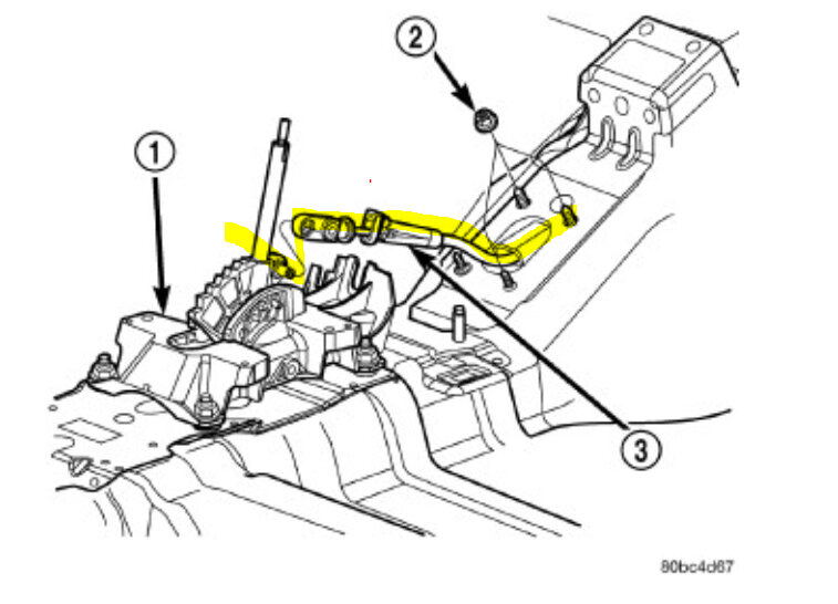

There is a shift cable that runs from the shifter inside the vehicle to the transmission under the hood. If it is loose and there is no resistance when shifting, the first thing I would suggest is to remove the center console and shift bezel. That way you can check if there are any broken parts, including where the cable attaches.
I attached the directions below for removing the console/bezel. Take a look through them and let me know if you are comfortable performing them.
joe

It could have been a few things. The cable may have snapped. The only way to confirm is to take it apart.
Let me know what you find.
Jan 2, 2024 at 6:26 PM
IRISHROSES4677
Hello! It was indeed the floor shifter, and it needs a new cable. I had enough and my mechanic has it. I just have to wait on a floor shifter (special order) and the cable. Sounds like it won't take too long to fix, they already have it pretty much apart just looking for the problem, haha.
