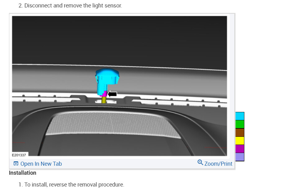

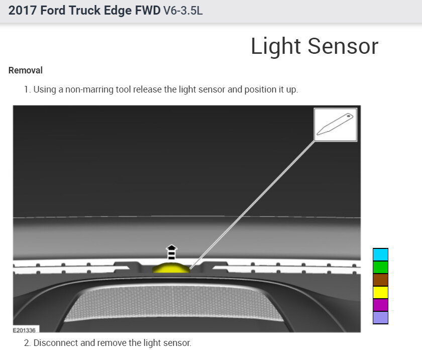

automatic dimmer no work no blue lite on dash lite up on brights our daughter has a 2017 edge same same hers doesn't work either headlight automatic
Nov 17, 2022 at 11:55 AM
  • 54,502 POSTS
There is an auto lamp sensor in the top center of the dash please make sure there is nothing covering it. If the sensor is uninstructed the sensor is probably bad. here is how to change it out so you can get the problem fixed. Check out the images (below). Please let us know what happens.
